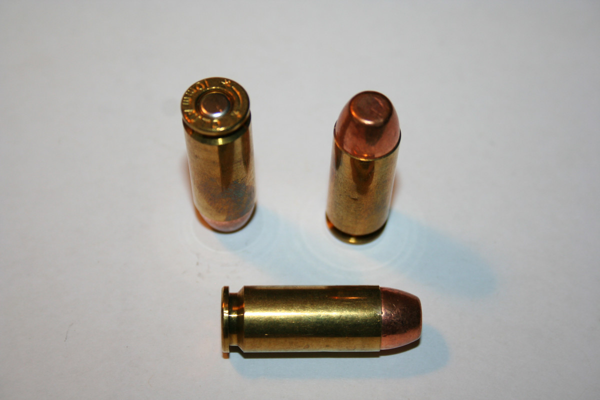

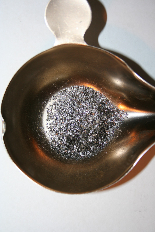

Here is the picture of the one cartridge with AA#9
