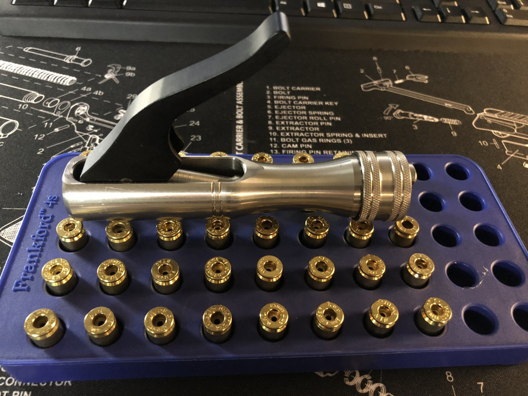

I spent Sunday evening unloading the rest of this ammo wth my RCBS kinetic puller, and then loaded up a new test batch starting at 75 grains with a max load of 79.5. I hope to test them one night this week.
