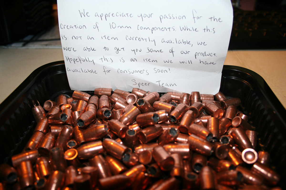

Yes I did write SPEER about having the 0.400" 200 grain Gold Dots made for handloader components back early in 2019 and they sent me a nice package of those & a thank you note in March of 2019.  Big thanks for Speer that they did make them as components soon after, but the economy & political climate things went south.

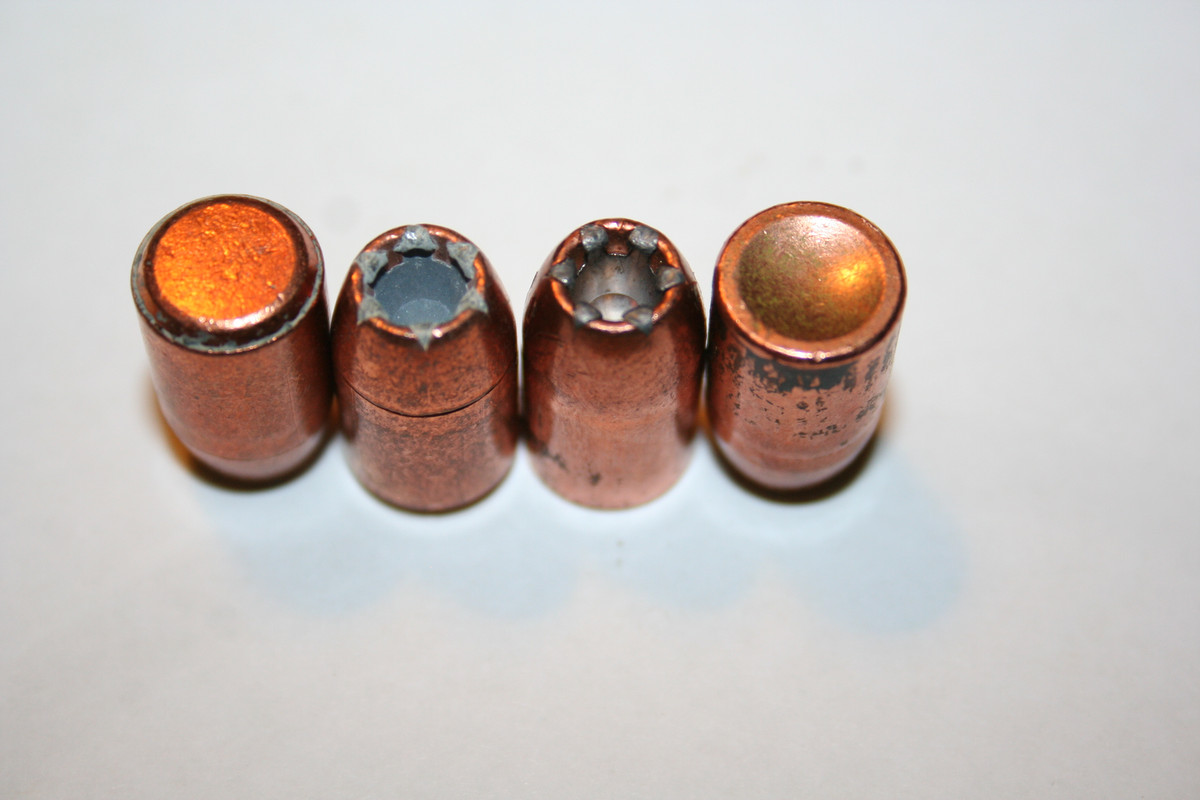

Speer actually used a black sealant on the bullets. Man, that made pulling them apart a little tough.  So much so that the primer pellet actually broke up and the yellow priming mixture was all mixed in the powder making it harder to determine what powder was being used.
Here is the OLD PULLED 200 grain GD from the Contract ammo next to the New SPEER 200 grain GD which has a concaved base.
