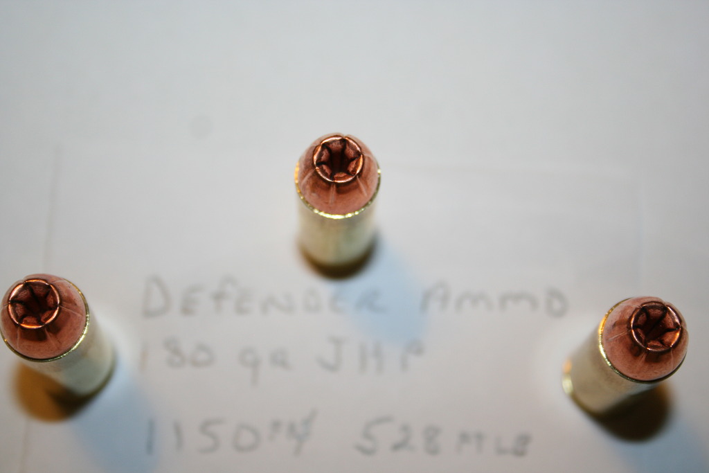

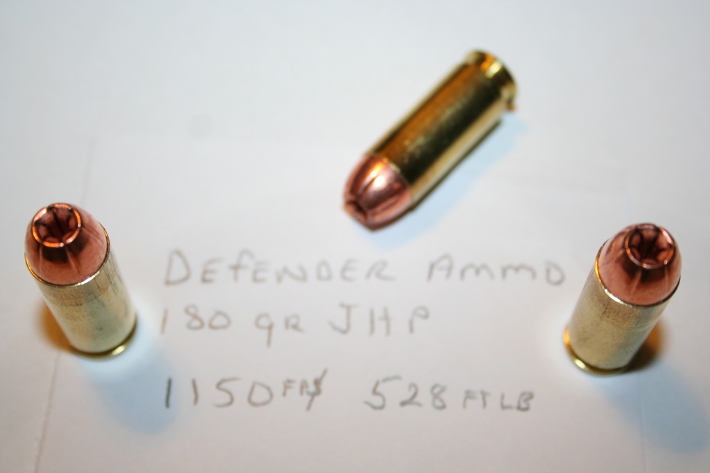

Defender Ammo 180gr JHP Plated (supplied by Blades 5/2016)
Started by The_Shadow, May 09 2016 10:27:35 PM MDT
Cartridge is from Ammo Manufacture: Defender Ammo 180gr Berry's Plated JHP (supplied by Blades 5/2016)
Muzzle Velocity: 1150 fps
Muzzle Energy: 528 ft. lbs
Brass Make/Headstamp: STARLINE - Brass
Bullet Make/Weight/Construction/Info; Length 0.6210"/Dia. 0.4000": 180gr plated JHP

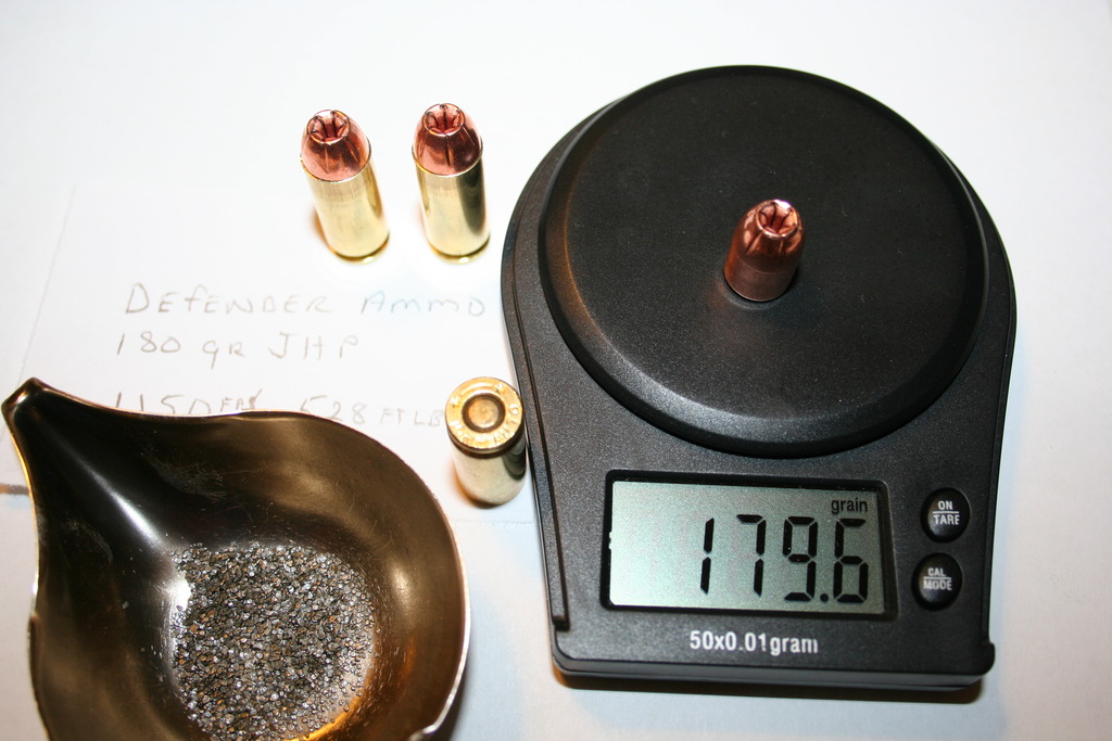

Actual weigh 179.6 grains / Flat base / Crimp Diameter 0.3975"
HP Dia 0.1000" / HP Depth 0.3450" tapered / Mouth 0.2440" (six deep segments)
C.O.A.L.: 1.2475" / 1.2500" / 1.2515"
Case: Diameter 0.4215" Crimp Diameter 0.4210" (medium crimp)Length 0.9860"

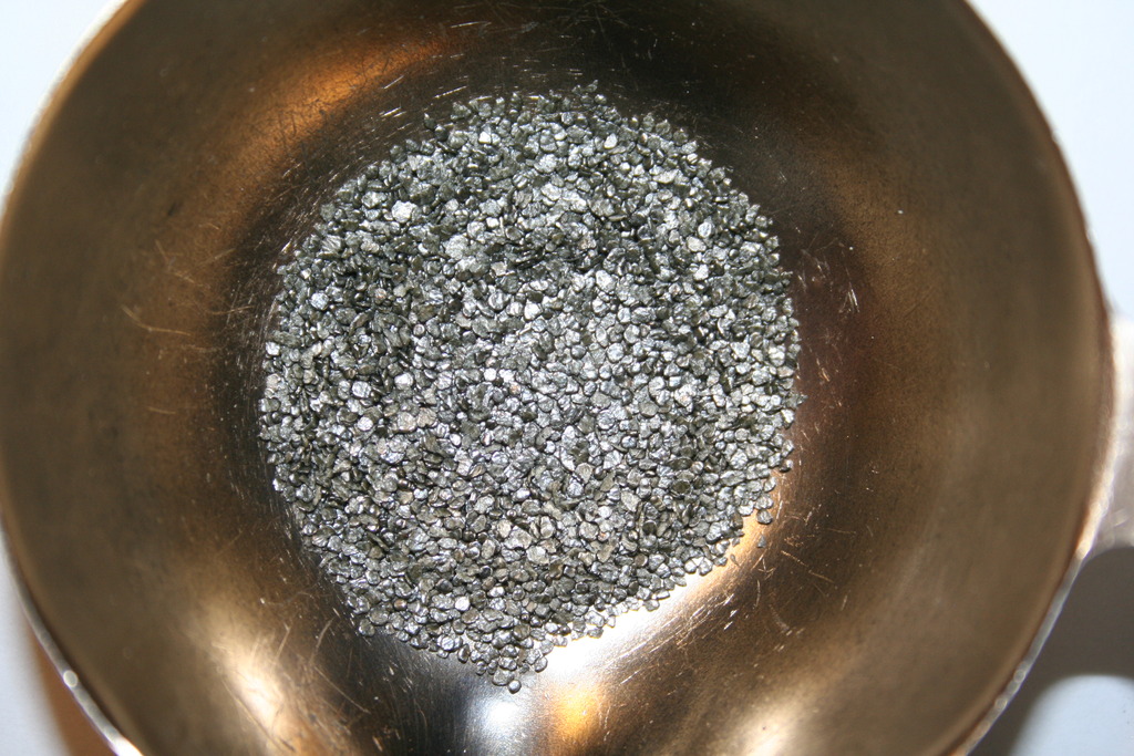

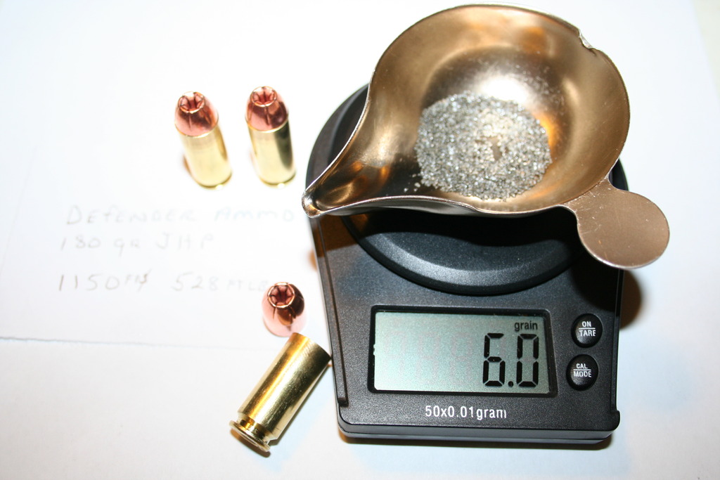

Powder Description/Positive ID/Type/Charge Weight:  TightGroup 6.0 grains
*(T-10 Torx bit fits inside the HP)(e-mail sent to see if I can find out which company is making the plated HP)

Never heard of them. The charge makes it a pretty low performer.
IC the 6.0 grains of TightGroup is a Hodgdon book loading @ 1141 fps developing 34,300 psi with the Sierra 180JHC.

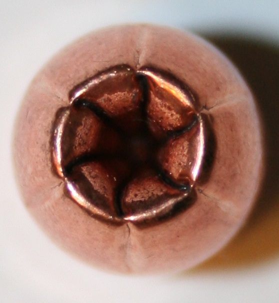

Here is a close up of the bullet, I find it interesting that HP cavity is deep @ HP Depth 0.3450".  The outside of the nose has skives that also rundown into the interior of the Hollow Cavity like a TORX.  Infact a T-10 TORX will slide inside.

It would be nice if they were around 1250 fps, maybe if we all email Defender they will add another grain or two of powder. It's better than the PPU I tried, I don't even want to use that for plinking.

Looking at the data from Armscor and Freedom Munitions (6.4 and 5.4gr's) puts this in the center. It should give about 1125 FPS.
