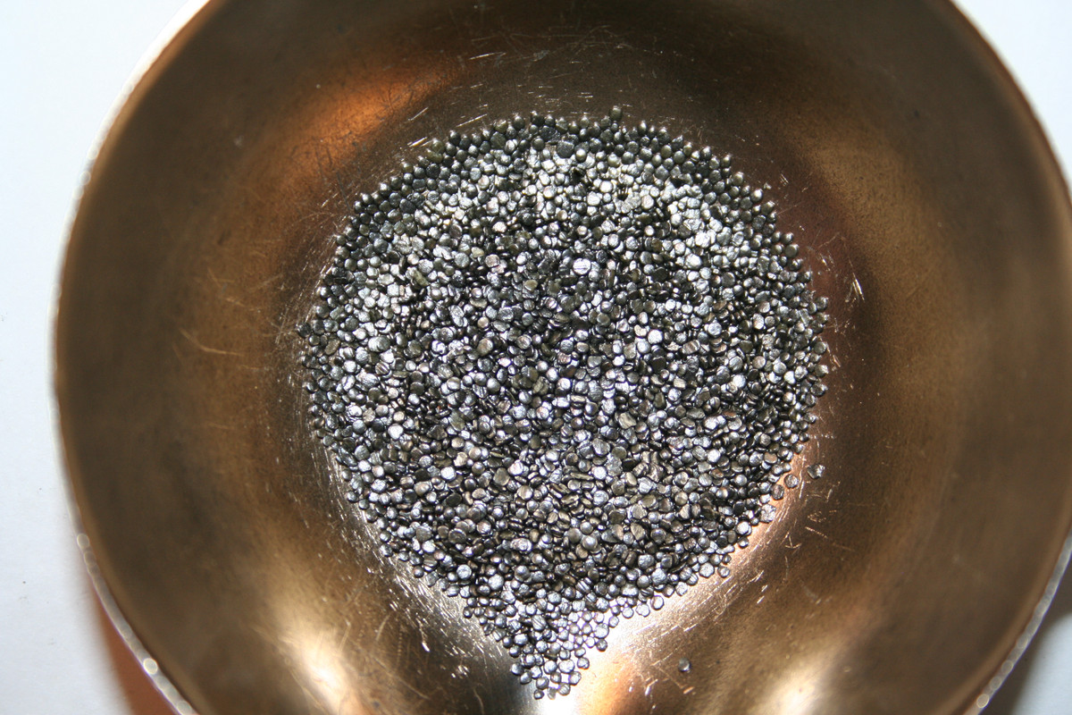

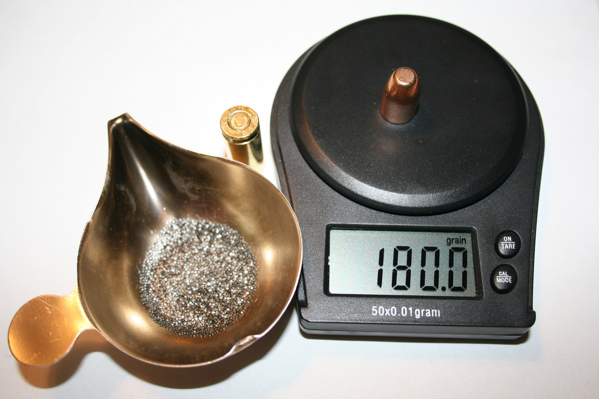

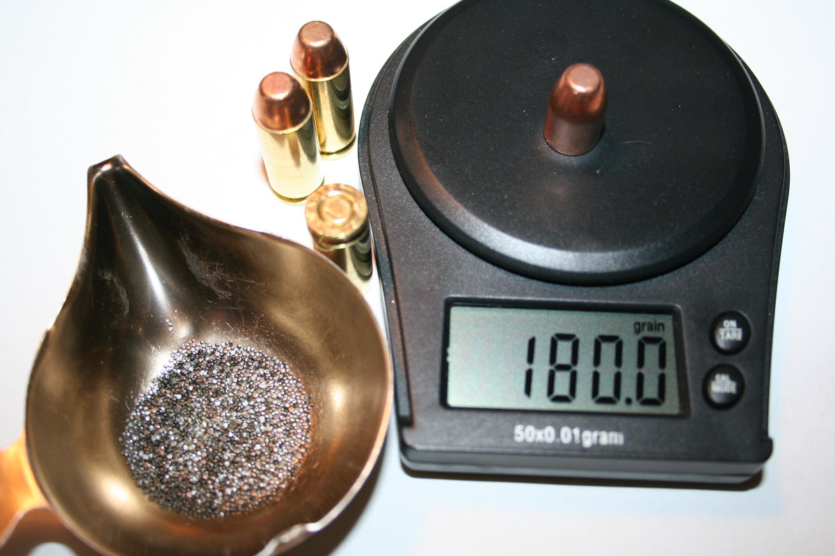

Cartridge is from Ammo Manufacture: Federal XM1003A 190gr Bonded TC JHP (supplied by 4949shooter)
Muzzle Velocity: 1090 fps (best velocity data I could find)*see notes
Muzzle Energy: 501 ft. lbs
Brass Make/Headstamp: Federal FC - Brass

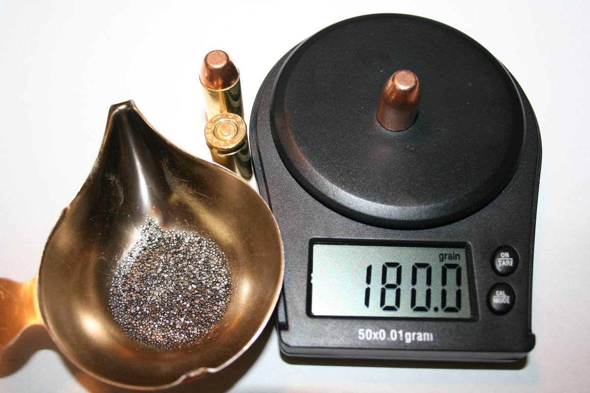

Bullet Make/Weight/Construction/Info; Length 0.6690"/Dia. 0.4005": 190gr TC JHP
Actual weigh 190.8 grains  Crimp Diameter 0.3995"
HP depth  HP 0.2240" / HP dia. 0.1400" (tapered inside) / mouth 0.2860"
C.O.A.L.: 1.2485"
Case: Diameter 0.4210" Crimp Diameter 0.4195" (medium crimp)Length 0.9880"

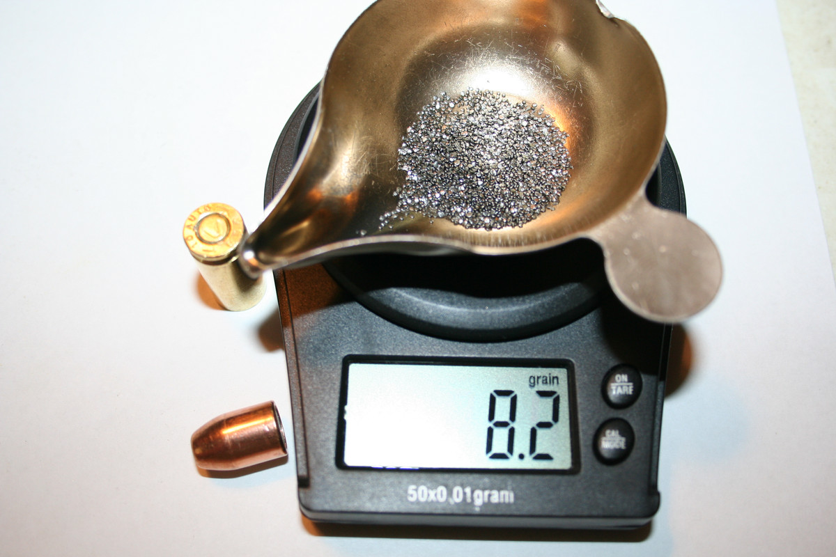

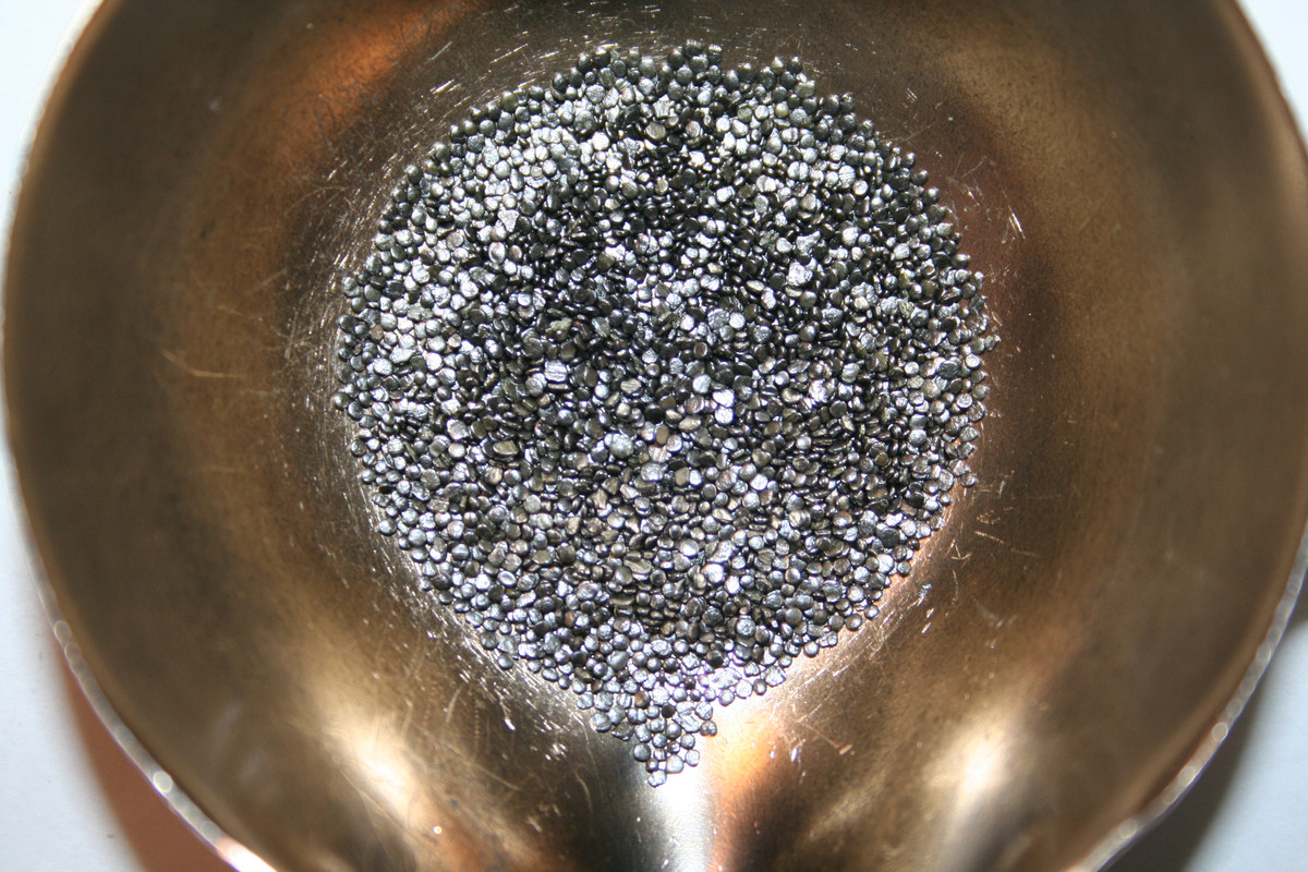

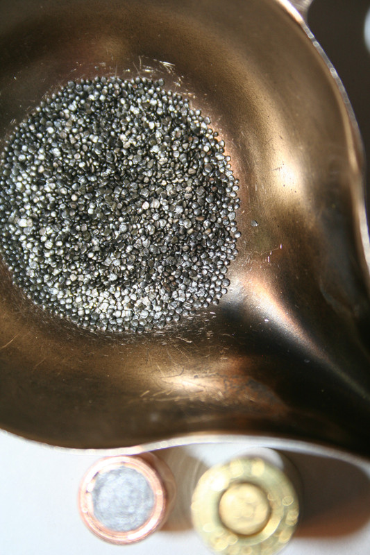

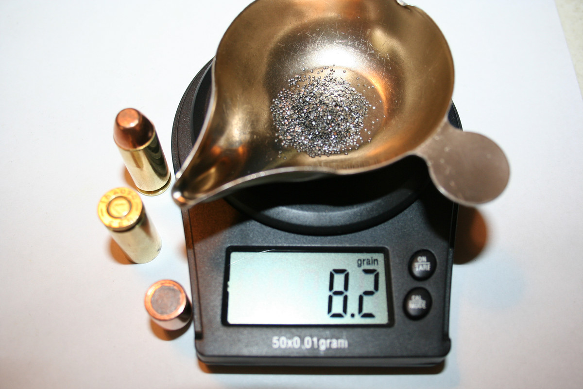

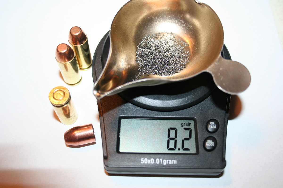

Powder Description/Positive ID/Type/Charge Weight: ? proprietary ? 7.2 grains  *
*Notes...
Found some older Winchester data; WAP was discontinued but is now branded are Ramshot Silhouette power...
Winchester data shows 190 FMJ using WAP 7.4 grains @ 1100 fps 27,800 PSI
Winchester data shows 190 FMJ using WAP 8.3 grains @ 1185 fps 34,700 PSI
(Small traces of yellow specks and some dust, maybe primer compounds)
The FBI got the specifics right (190-grains @ 1090 fps)
FBI load was the Federal 190gr. bonded JHP ( XM1003A ) at about 1050-1090fps from their S&W 1076s
Still studying more info...The more I study the more I lean to WAP as being the powder and the velocity will be lower near 1090 fps as suggested by 1050 - 1090 fps the FBI stated...
