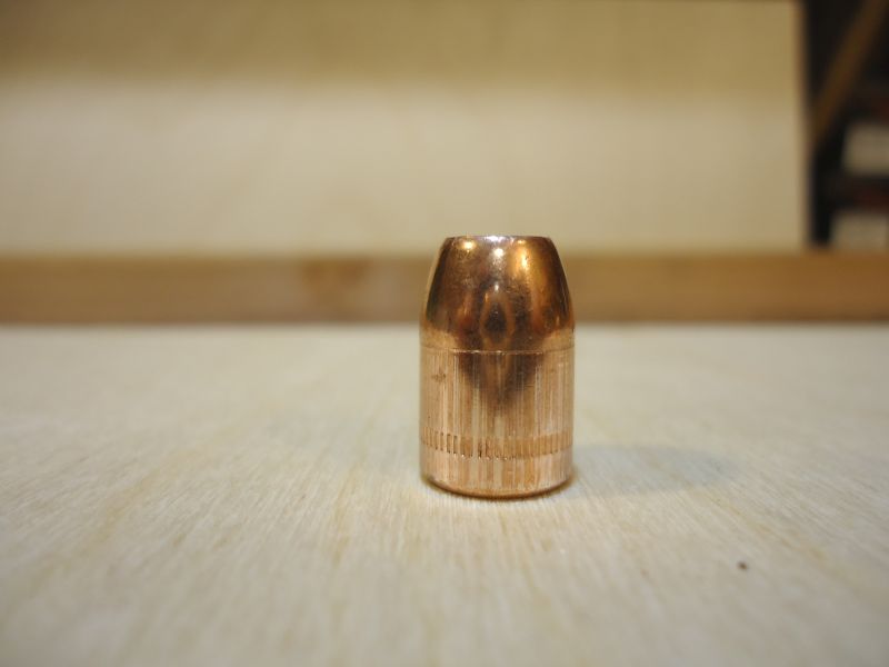

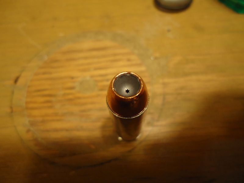

Bullet Make/Weight/Construction/Info: 180gr V-Crown JHP .4000" dia;  .613" long

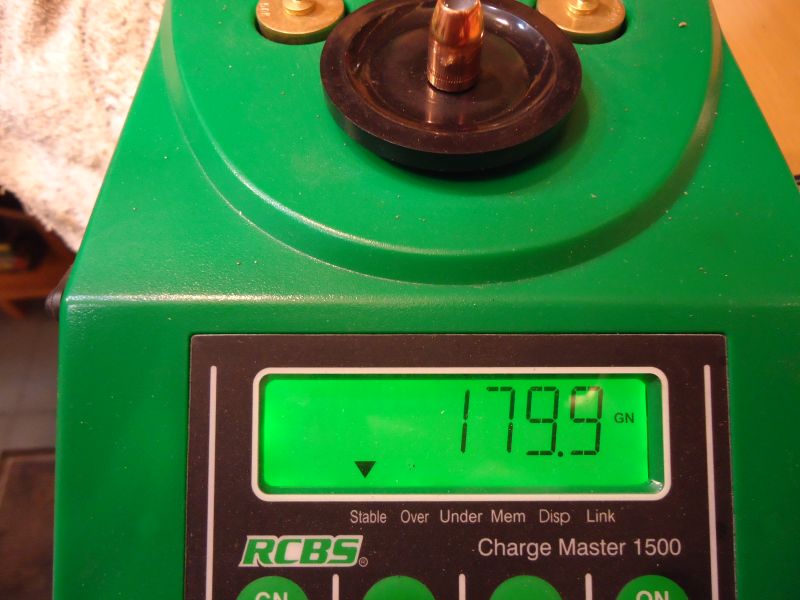

Actual Weight: 179.9grs

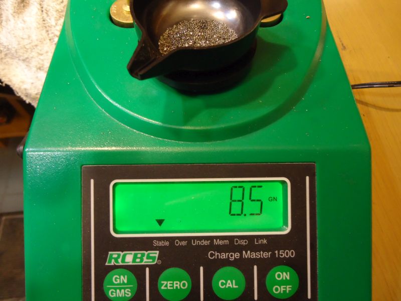

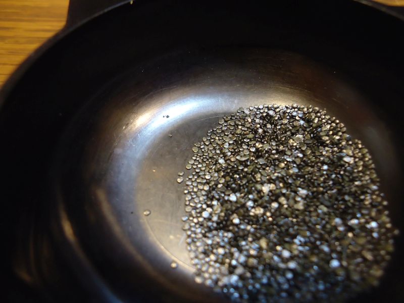

Powder Description/Positive ID/Type/Charge Weight: Flattened ball; 8.5grs.

Velocity is about what one would expect from 8.5grs of propellant.
Wow Dub01, that is a different loading than the previous 180 gr V-Crown pull-down.
This one appears to be AutoComp.
Hodgdon shows the 180 JHC with 7.7 as 1199 fps 36,000 psi.
