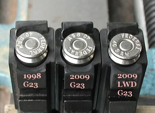

Not 10mm, but here are pictures from a late 90's G23 vs a 2009 G23
This shows a good bit more support by 2009.

It looks about like the photo of the 2009 G23, but I don't have any newer Glock 20 factory barrels to compare chamber support
That's a night and day difference between the late 90's G23 and 2009 G23!  Thanks for the pic.  I wonder if 2015 G23 barrels are any different.
Hopefully someone can post a pic comparing two actual 10mm Auto Glock barrels.
