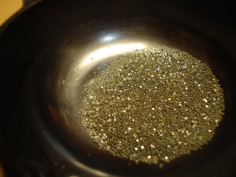

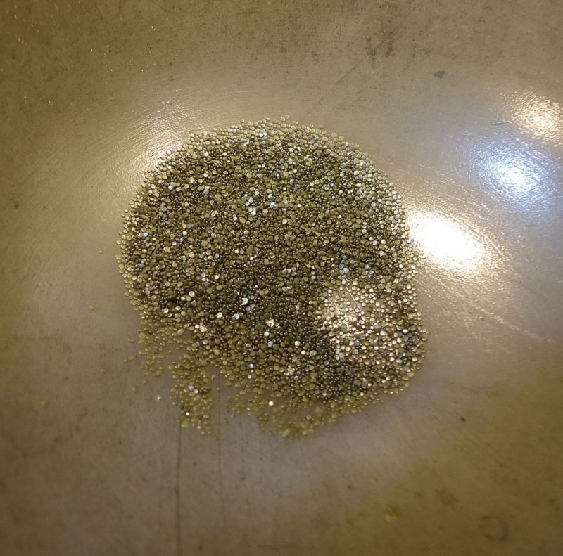

Powder charge 10.8 grains;
Close up in pan;
Close up in bowl;

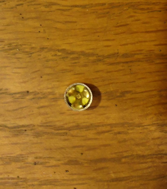

Primer;

Any guesses as to what powder this is?

Our old pull-down showed 11.0 of #7.

Hello RDub01, its been a while.  Glad you were able to drop in and post the info.  To me it looks like AA#7, and based on the charge weight it fits the load data, however I don't know if it would make that velocity as advertised... :-[
