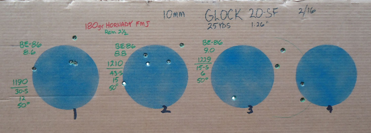

Alliant's data indicates they got 1265 fps with a 180gr jacketed bullet and 8.5grs of BE-86. Seemed like a pretty remarkable claim for 8.5grs of powder..  So assembled some rounds with the Hornady HAP bullet and following their recipe with Fed 150 primers;
Well 1265 fps wasn't quite achieved, but not bad..
After miking the brass, it was clear this wasn't a very hot load. So I assembled a few more rounds at 0.2grs increments.
Well, case expansion wasn't what I was expecting, but we must be careful here.. This was done in rather cool weather, so we might get something totally different in warmer temperatures.
Did this again using the Rem 2½ primer;  Slightly warmer temps.
So BE-86 did Ok..  Not as good as N-350 in this gun.

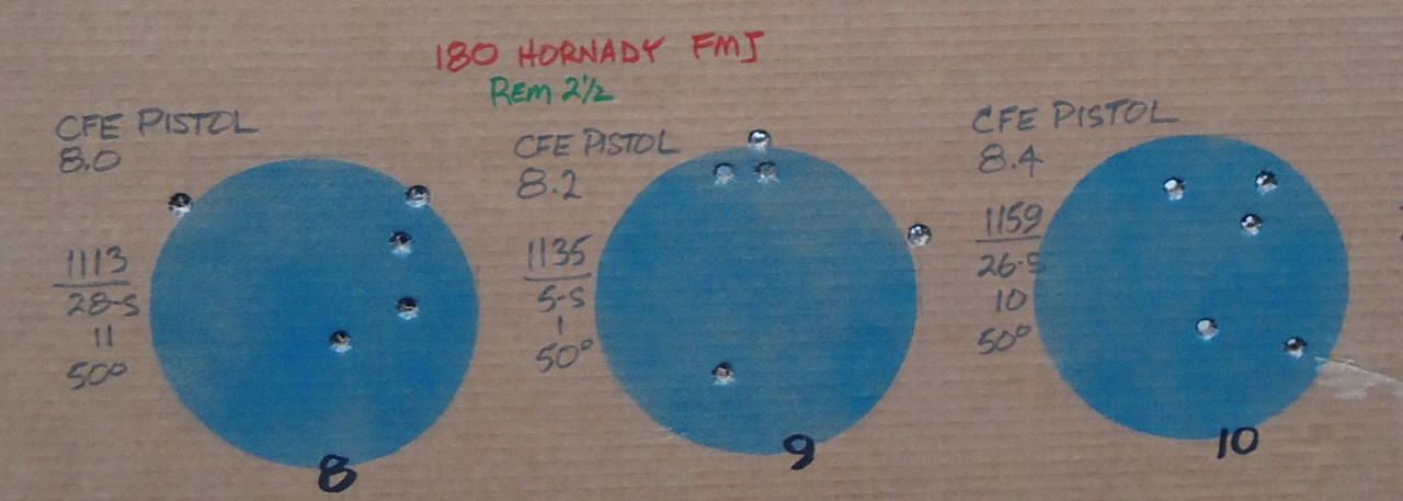

CFE Pistol;
IMR lists 7.6grs with a 180gr bullet, so shot some with Hornady 180gr FMJ and CCI 300 primers.
Case expansion was minimal, so this can be taken out some more..
Shot three more groups using the Rem 2½ primer.
CFE Pistol was Ok as well..  8.4grs was knocking on the door of the .4340" mark so I stopped there.

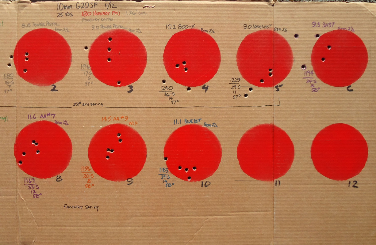

Shot some more groups with the Hornady 180FMJ making some comparisons against the Speer bullet.

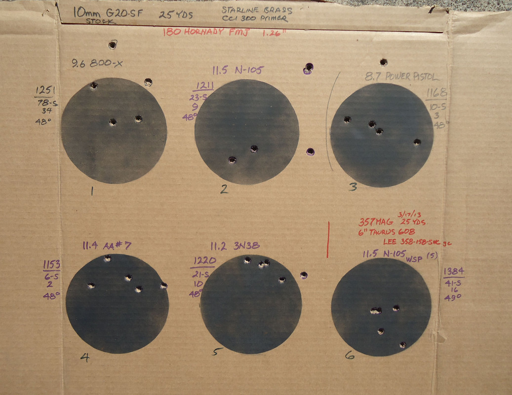

This target indicates the gun's continuing dislike of N-105... (The 357Mag loves it!)
Here is one using the stock spring and the ISMI 22# spring;

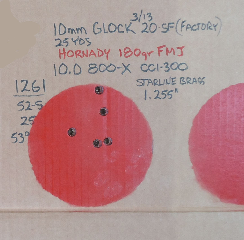

And lastly, one of my favorite loads;
That's all I have for the Hornady bullets.

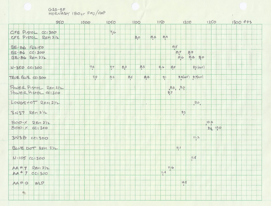

Here is the data for part 2;
A graph of the project;
