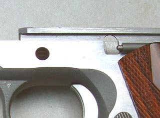

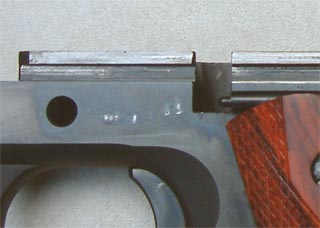

It is true that the frame on early 1911's experienced a crack in the thin part of the rail above the slide stop cutout.
However, this was not a "structural issue".  This was a design issue.
A structural issue would be rectified by adding strength to the frame to compensate for the failure. Colt's solution to this problem was to remove the section of rail where the crack would form.  You can't crack what's not there!
The issue was simply that Colt had originally designed the gun wrong.  It was just SO over-engineered that until the 10mm came along, the element of the design that focused stress into the thin rail section was never manifest. This crack was purely cosmetic and in no way affected the function of the gun.
However, customers demanded, and not wrongly, that Colt repair or replace frames.  Many of them, not understanding that this crack was a non-issue, made lots of noise about the frames being "weak", which was not true.  In the end the simplest course of action for Colt was to just remove the rail above the slide stop port.
The issues with the 3rd Gen Smiths, though only to the FBI version of the guns, was that under 10mm recoil the trigger mechanism could lock up the action.  This did affect function as the only way to resolve the issue was a trip to a S&W Armorer.  In fairness to S&W, the changes to the firing mechanism that allowed this to happen were mandated by the FBI.  But, S&W should have forseen the issue and corrected it.
IMHO neither one is a reason to overlook either of these fine 10mm firearms.  The magazine capacity, compared to modern designs that hold twice the ammo for the same weight may be a perfectly valid reason to look beyond these guns though.
