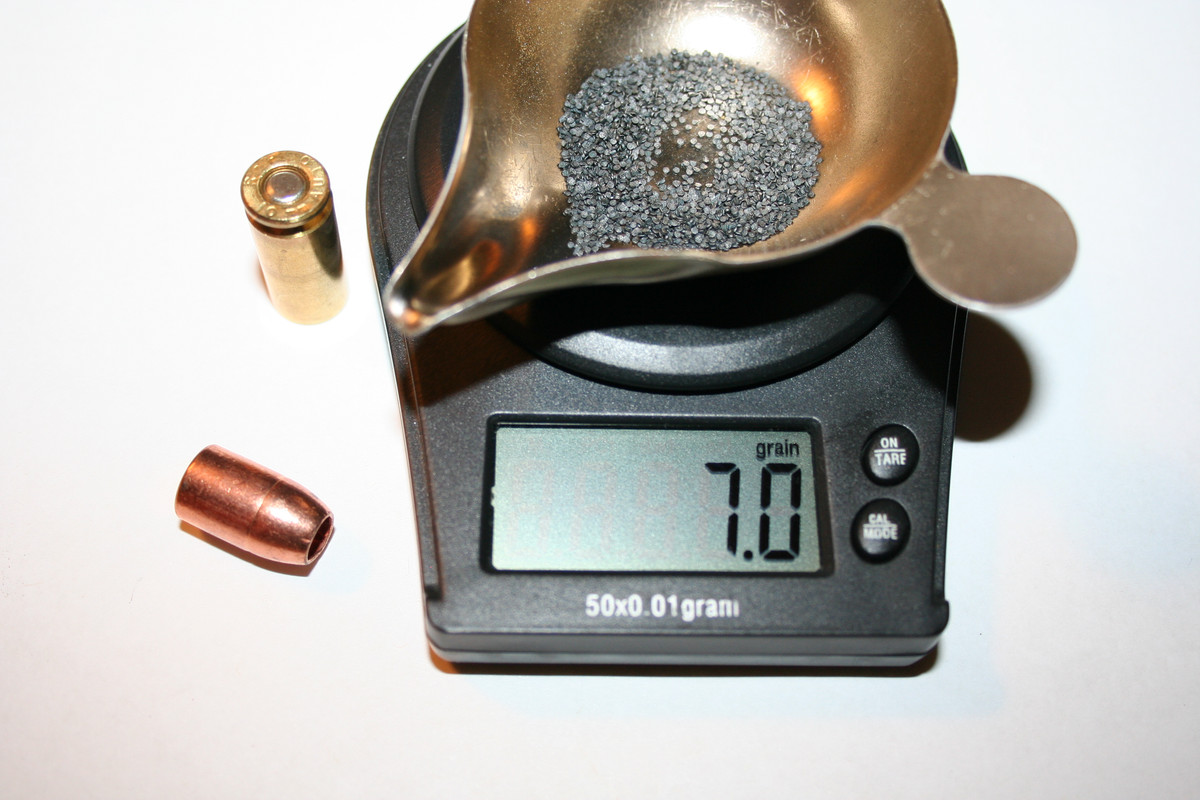

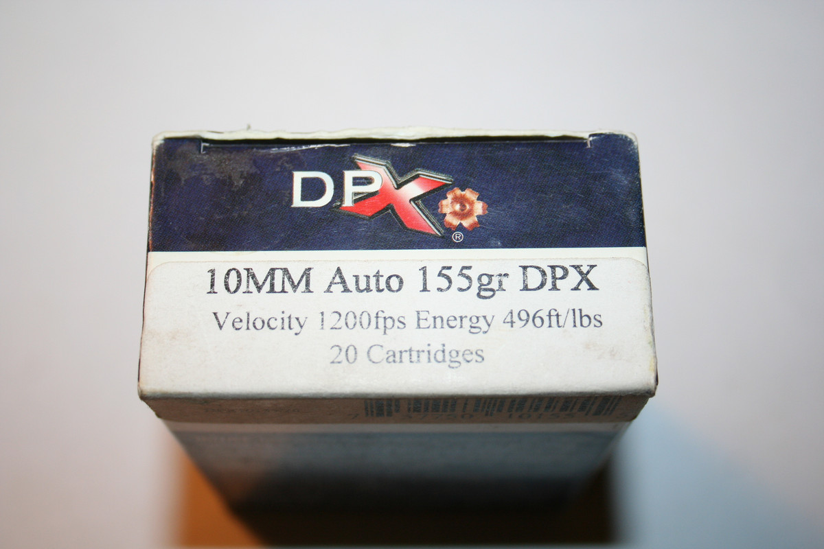

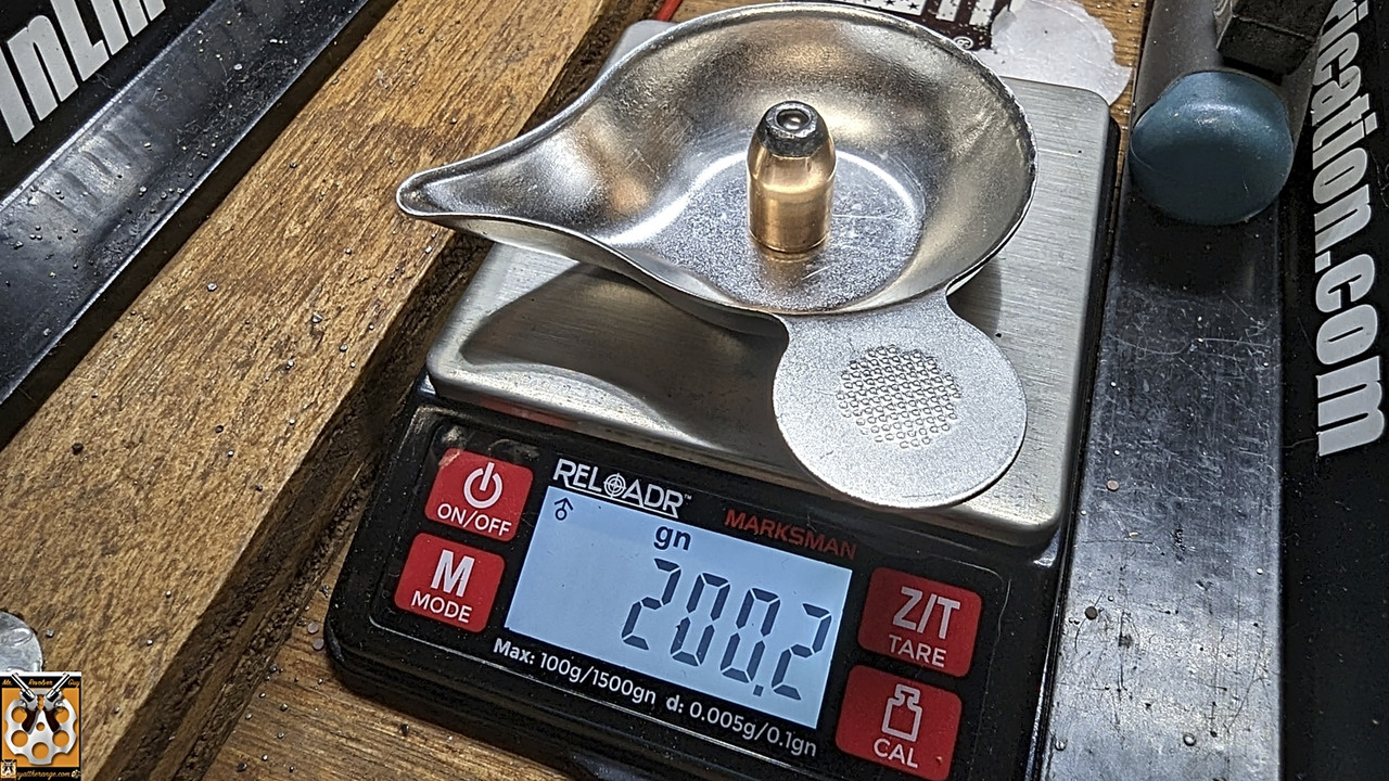

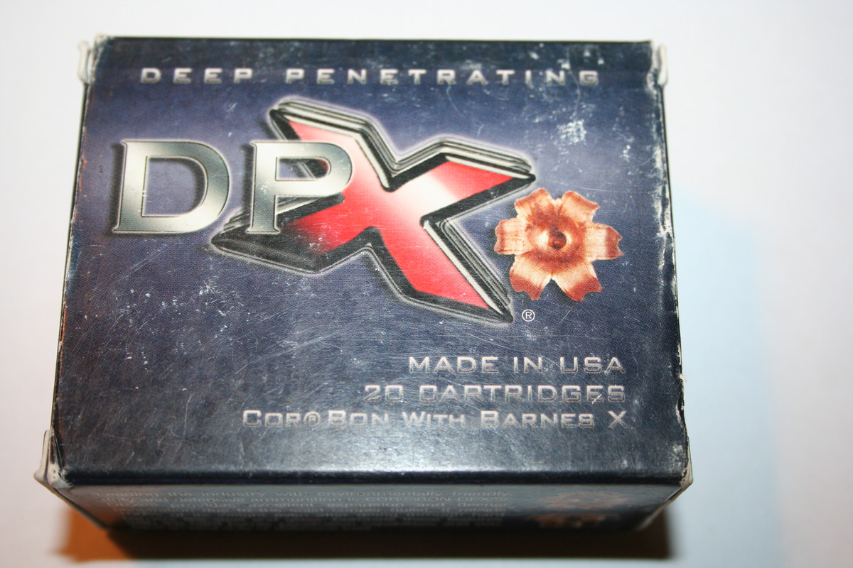

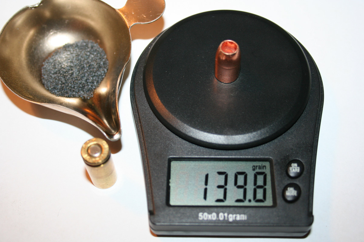

Cartridge is from Ammo Manufacture: CorBon 155 gr DPX  Deep Penetrating Xpanding The bullet made by Barnes  (drsjr1969 DAVID)
Muzzle Velocity: 1200 fps
Muzzle Energy: 496 ft. lbs
Brass Make/Headstamp: Remington R.P. - Brass

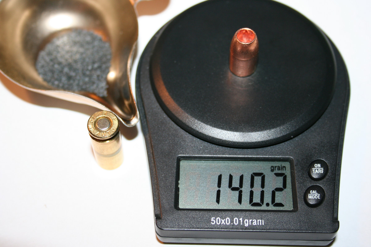

Bullet Make/Weight/Construction/Info; Length 0.6850"/Dia. 0.4000": 155gr DPX
Actual weigh 139.8 / 140.2 grains  Crimp Diameter 0.3950"  (NOTE these were only 140 grain bullets)
HP depth 0.3725" (straight) / HP dia. 0.3000" / outer mouth dia. 0.2700"

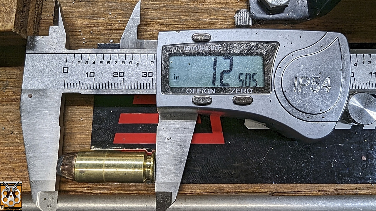

C.O.A.L.: 1.2600"
Case: Diameter 0.4210" Crimp Diameter 0.4200" (med crimp)Length 0.9915"

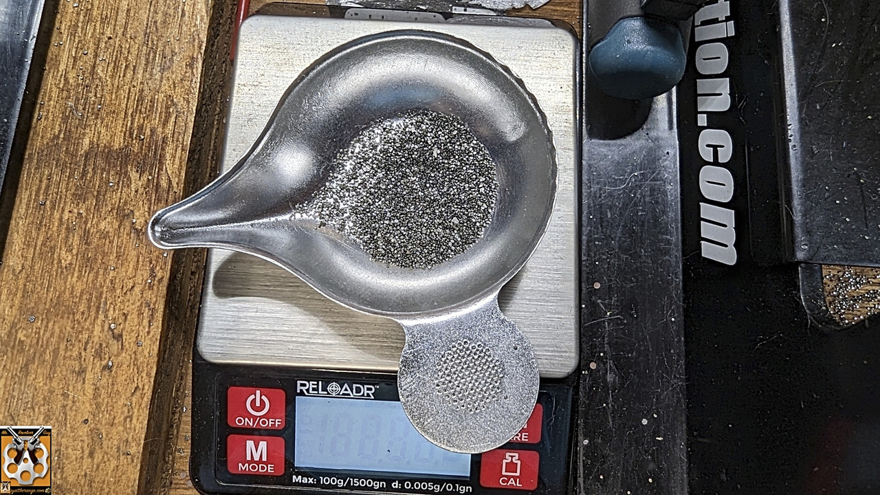

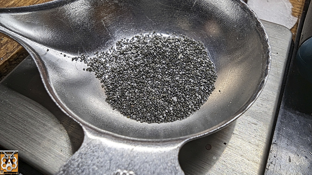

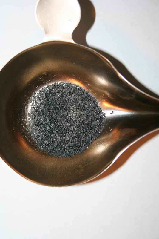

Powder Description/Positive ID/Type/Charge Weight: Alliant Power Pistol 7.0 grains
