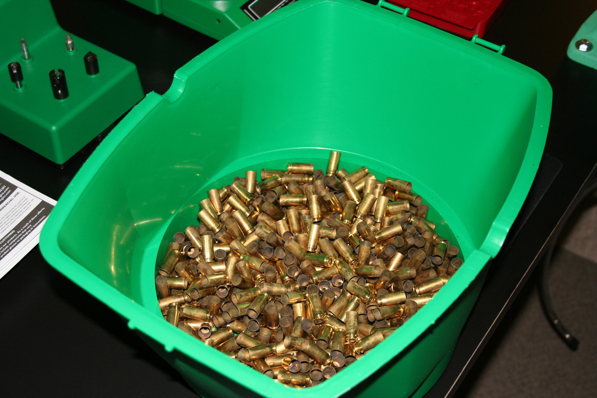

Here is my process:
- catch / pick up my and all other cases I can find at the range
- shake all brass in a wide container with mesh on the bottom in order to get rid of sand and most dirt
- sort brass by caliber
- decap all brass from one caliber in my Redding UltraMag with a cheap Lee decapping die
- wet tumble with SS pins for 30 min in a warm water / Lime Shine / Frankfort Brass Cleaning Solution
- Separate from SS pins and rinse under cold water
- Spread out on towels and let dry in sun, and over night. Do NOT use any dryer - makes them sticky.
- clean / uniform / size pockets to my specs
- resize case
- store in large, air tight Rubbermaid 1776473 Food Containers

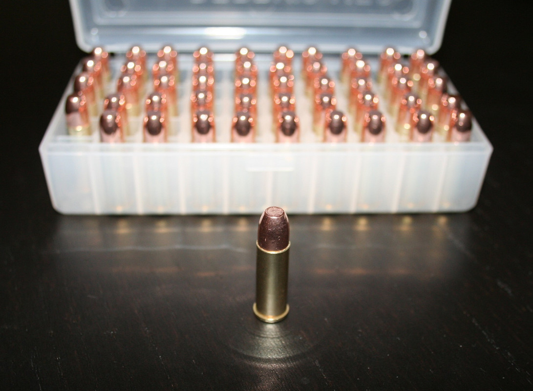

The loaded rounds get dry tumbled in walnut media with some Nu Finish Polish and Sealant, which makes the following cleaning and reloading cycles MUCH easier.
The polish also helps with feeding.
You won't find cleaner ammo anywhere  ;D
