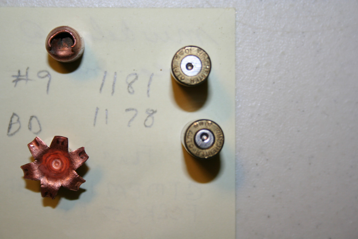

The older AA#9 I had was 100% microbeads and max loads were compressed to which it would push the seated bullet back out.  It also produced one of the flattest primers in my test with 140 grain Barnes TAC-XP.
12.6 grains of AA#9 (had to adjust powder shoving the bullet back out 1.270")(Totally compressed @ 12.6 gr.) @ 1181 fps, Primer was totally flattened to the edges. It penetrated 5" of sandy dirt and the bullet failed to open, partially folded in on itself. Case expanded to 0.4280"
See photo.
AA#9 Microbead formulation
