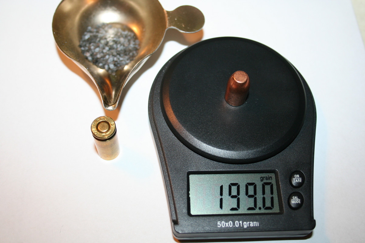

Bullet Make/Weight/Construction/Info; Length 0.6600"/Dia. 0.4000": 200gr Speer TMJ
Actual weigh 200.0 grains  Crimp Diameter 0.3970"

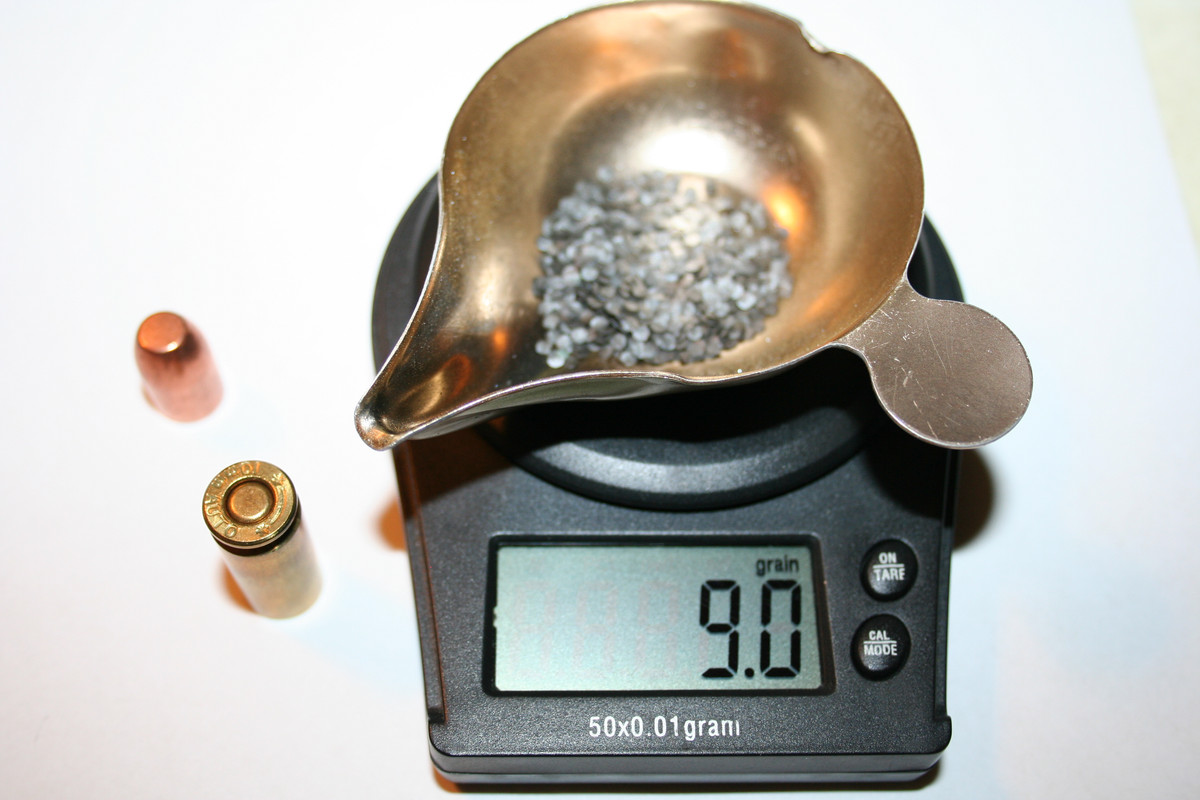

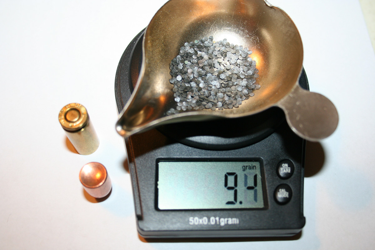

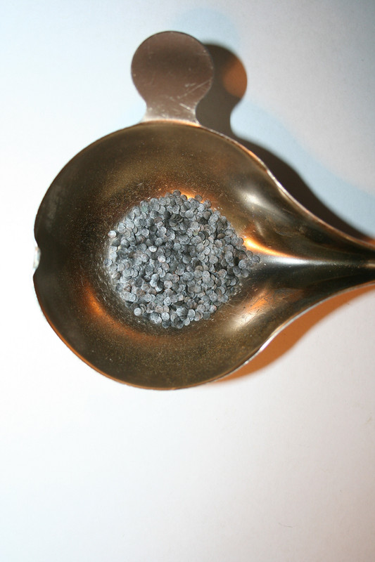

Powder Description/Positive ID/Type/Charge Weight: 800X 9.0 / 9.2 / 9.4 grains
