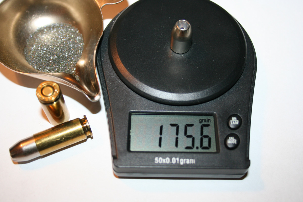

Cartridge is from Ammo Manufacture: Elite Ammunition Winchester 175gr Silvertip JHP (DAVID drsjr1969)
Muzzle Velocity: 1322 fps Witness  S&W 610 6.5" 1340 fps
Muzzle Energy: 677 ft. lbs                 698 ft. lbs
Brass Make/Headstamp: Starline - Brass

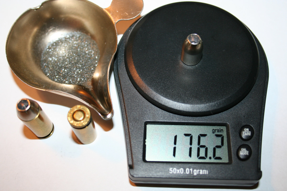

Bullet Make/Weight/Construction/Info; Length 0.6195"/Dia. 0.4005": 175gr. SilverTip JHP  depth 0.3450" / Inside Dia. tapered / mouth Dia. 0.2290"
Actual weight 176.2 / 175.6 grains   Crimp squeezed bullet to 0.3995"
C.O.A.L.: 1.2550" / 1.2545"

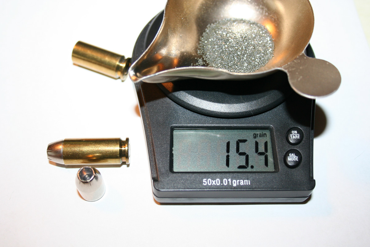

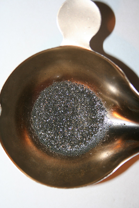

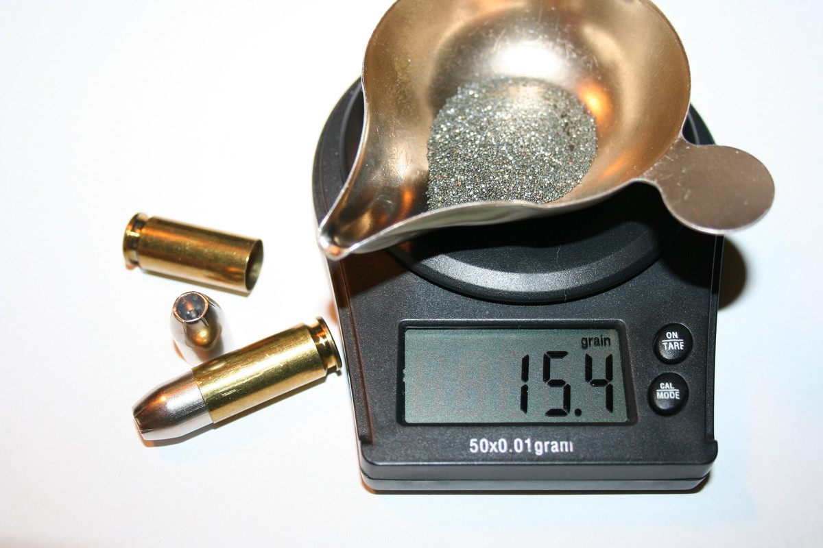

Powder Description/Positive ID/Type/Charge Accurate #9  Weight: 15.4 / 15.4 grains
(Compressed Load)
