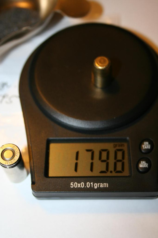

Cartridge is from Ammo Manufacture: Black Hills 180gr TMJ (maybe plated)
Muzzle Velocity: 1050 fps
Muzzle Energy: 440 ft. lbs
Brass Make/Headstamp: Federal FC – Brass (used)
Bullet Make/Weight/Construction/Info; Length 0.5790"/Dia. 0.3990": 180gr TMJ
Actual weigh 179.4 grains  Crimp Diameter 0.3990" / front of bullet 0.4005"
MEPLAT  0.2675"
C.O.A.L.: 1.2550"
Primer: Nickel color
Case: Diameter 0.4230" Crimp Diameter 0.4235" (light crimp)Length 0.9835"
Powder Description/Positive ID/Type/Charge Weight: Unique   6.8 grains

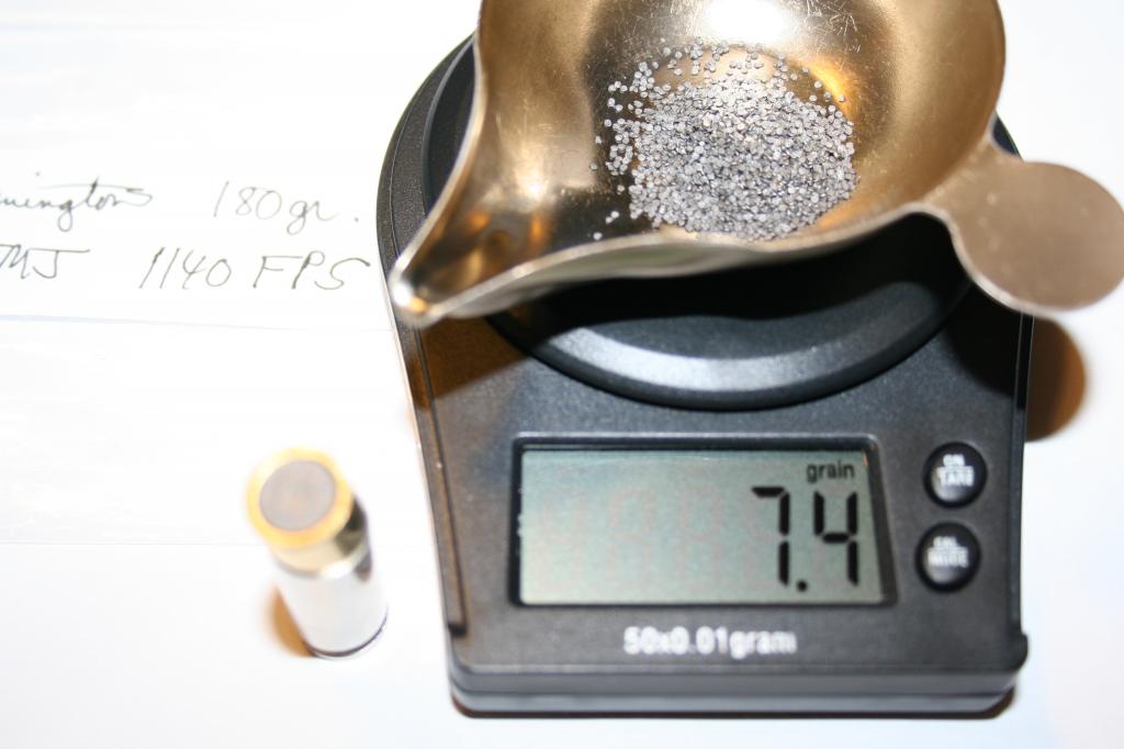

Cartridge is from Ammo Manufacture: Black Hills 180gr JHP
Brass Make/Headstamp:  PMC – Brass (used)
Bullet Make/Weight/Construction/Info; Length 0.6370"/Dia. 0.3985": 180gr JHP
Actual weigh 180.8 grains  Crimp Diameter 0.3990" / front ahead of crimp 0.4000"
HP depth  HP 0.2680" / HP dia. 0.1200" / mouth 0.2190"
C.O.A.L.: 1.2620"
Case: Diameter 0.4245" Crimp Diameter 0.4235" (light crimp)Length 0.9895"
