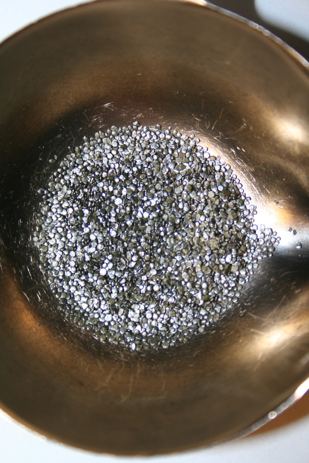

Powder Description/Positive ID/Type/Charge ?? AA# 5 Weight: 8.4 grains
