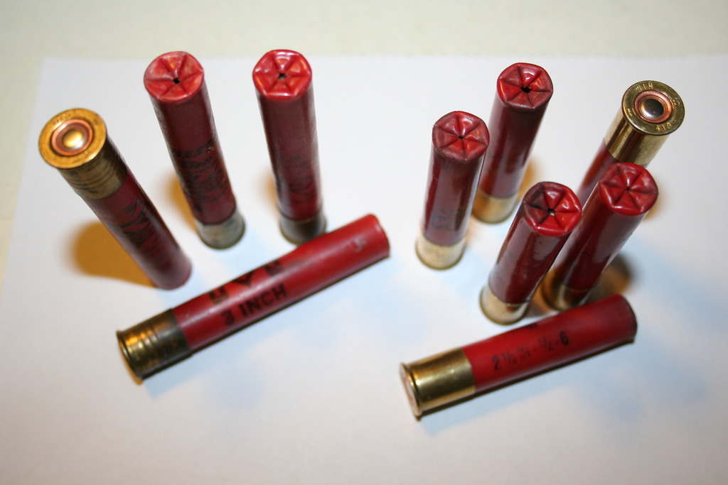

I was just wondering if anyone is handloading for the 410 bore/ga shotshells?
I have an old LEE kit that I am utilizing to get the job done.
The kit has most of the tools.
It has the steel sizer and deprimer die which is also used to tap the final crimp down.
One end is cut so to stabilize the base of the shell casing so you can punch out the spent primers with the de-capping tool.
Things I found to help resizing the brass section.  I used my LEE 45ACP FCD, with its guts removed to take advantage of the carbide ring for resizing.  I repriming while resizing the case as I push the casing up into the FCD sizing ring, the tap out the resized reprimed casing using a flat bottom punch 0.308" so as not to contact the primer from inside.
Then I measure out powder for each casing and push the appropriate wad inside to avoid spillage or powder loss...
The kit has shot dippers for 1/2 oz, 5/8 oz and 3/4 oz weights.  I using 1/2 oz for the 2 1/2" shells  11/16 oz for the 3" shells.
The kit has a plastic 6 segment crimp starter that you can push down on the case mouth to start the 6 folds into a point closing the shot inside.  I found I can sort of press this between the ram and die at the top of the press to add more forming pressure.
Then to finish the crimp I use that steel sizer with the steel plunger to tap down the crimp folds to finish.  This is the tricky part to get it right with out inverting the crimp too deeply.

These were loaded for my nephew to have some fun with his single barrel Rossi...but the challenge was using the tools I had to make them work, the wads were for 3" shells so for the 2 1/2's I needed to trim about 3/8" off the wads.
Takes a while to load them but I was developing a systematic process to get up to speed... :D
