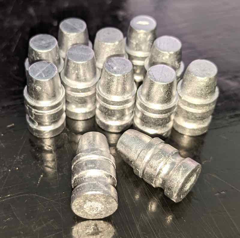

New NOE mold arrived yesterday.  Model 360-152-SWC-V5.  Cast up about two hundred to test out the mold:
Cast from isotope lead out of a 750°F pot they fall 0.362" and 153 grains and every so slightly frosty under magnification.  They size down easily to 158 and look great for both 357 mag and 38 Super.
I have tested a dummy round in 38 super in my Witness Stock III and seated 1.270 it fits the magazine and passes a plunk test.  Next step is to work up some data, probably using AA#7, AA#9, Blue Dot, BE-86 and maybe CFE Pistol.
Very nice looking Keith style bullet.
Way nice looking, great job!

While I was heating the pot I got in a conversation with my son and mom and wasn't paying attention.  The mold, which I was warming on the top of the pot, got very hot.  As a result the first pour took several minutes for the sprue to cool and the bullets were heavily frosted.  I set them aside to take some measurements.
Those bullets are measuring out .0005" larger than the average for the rest of the pot.  I had always heard that frosty bullets were larger, but had never tested it myself.
#8
I like to see a slight frost the temps being up help fill out.
