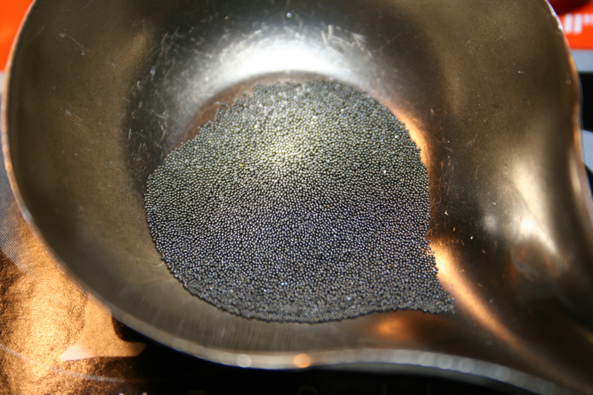

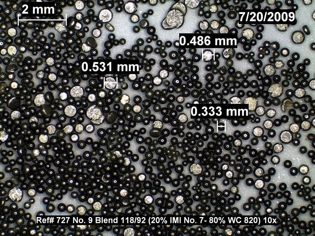

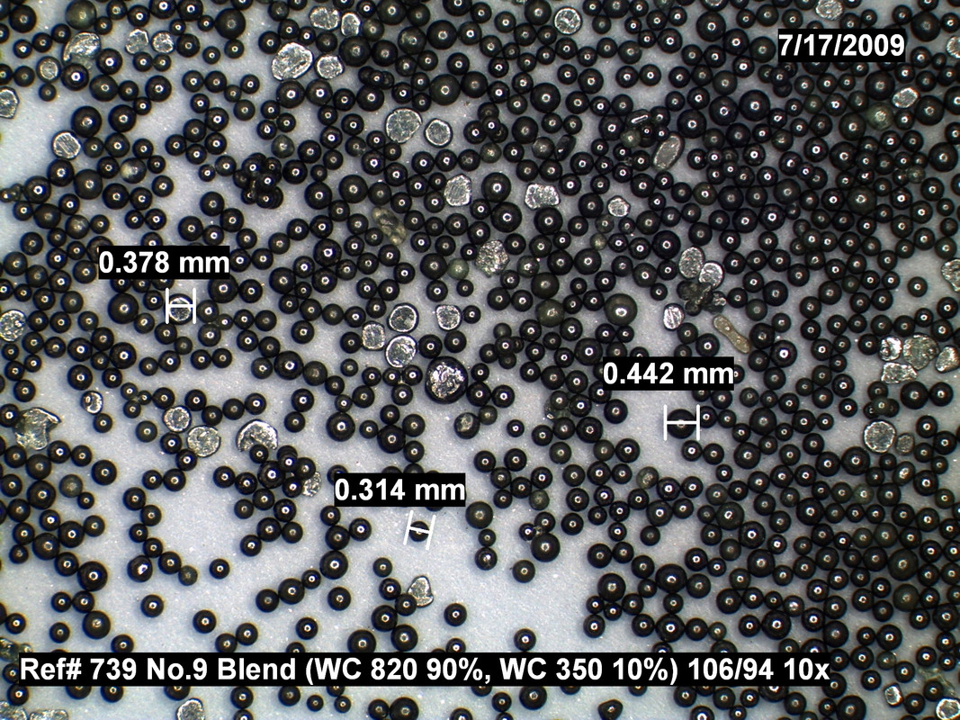

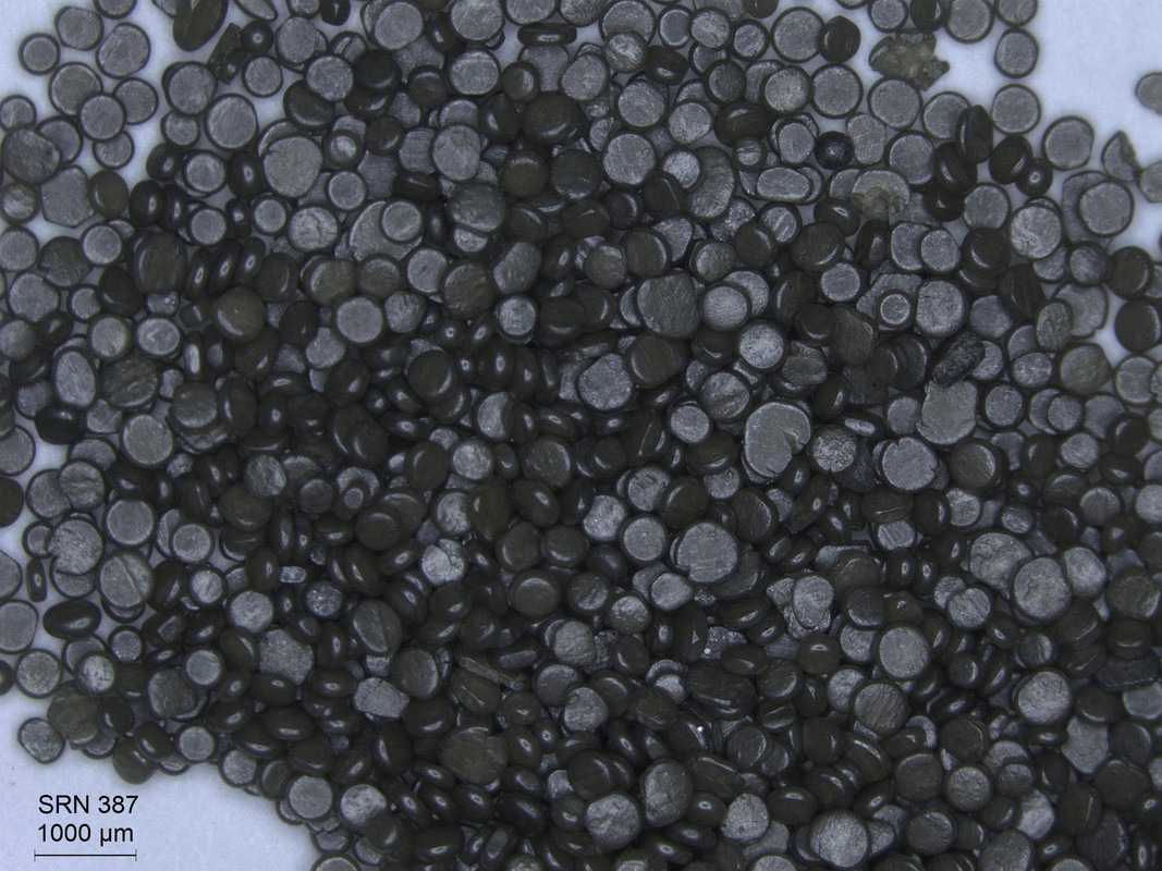

My concerns are with Accurate #9 powder.  Over the years there have been several variations of the formulations.
My first canister of AA#9 was the microbead which was said to be WC820
Later they had mixture of WC820 80% and WC350 10%
Next was WC820 80% and Accurate #7 20%
This is the newest formulation 100% flattened ball which we see today as a total reformulation.
This newest formula of Accurate #9 seems to be the best with the homogeneous formulation of all of the older ones that were blended mixes...
