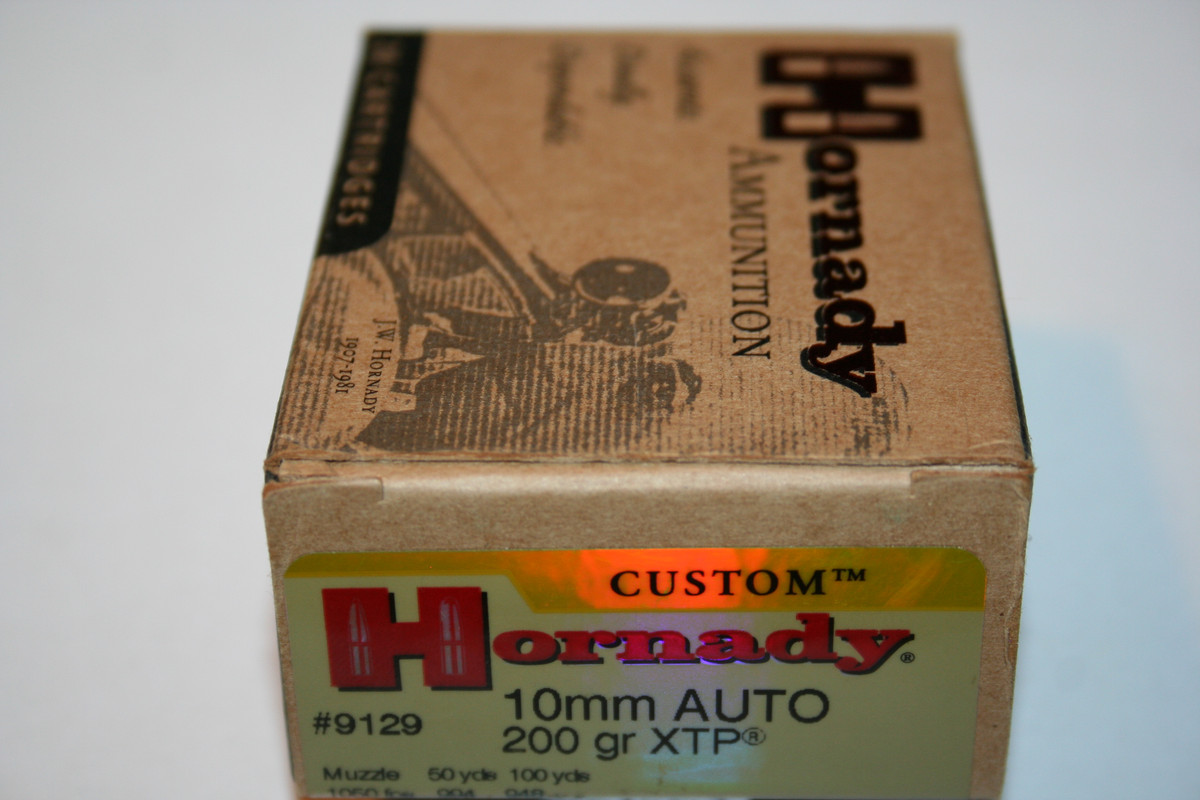

Hornady Custom (#9129) 200 gr XTP
Started by The_Shadow, June 08 2025 04:51:37 PM MDT
Cartridge is from Ammo Manufacture: Hornady Custom (#9129) 200 gr XTP (DAVID drsjr1969)
Muzzle Velocity: 1050 fps
Muzzle Energy: 490 ft. lbs
Brass Make/Headstamp: HORNADY - Brass

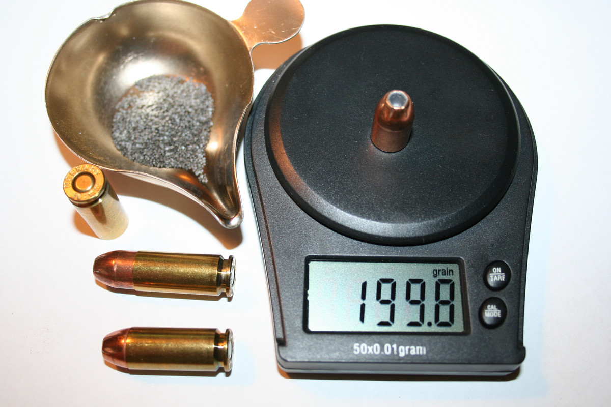

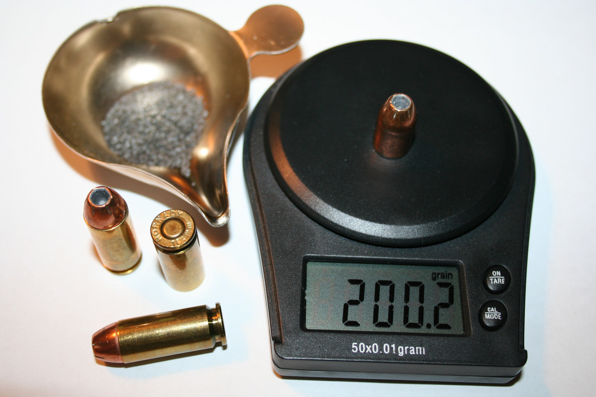

Bullet Make/Weight/Construction/Info; Length 0.6795"/Dia. 0.4000": 200gr Hornady XTP
Actual weight 200.2 / 199.8 / 200.0 grains  Crimp Diameter 0.3965"

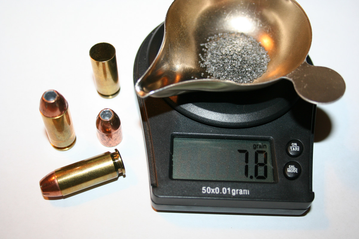

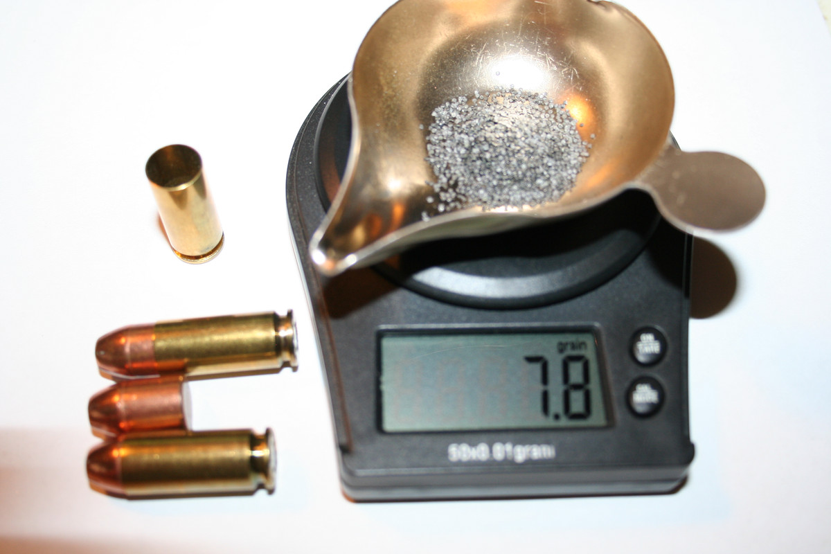

Powder Description/Positive ID/Type/Charge Weight: Power Pistol 7.8 / 7.8 / 7.8 grains
Real consistent...Cartidge Weight  284.8 gr  2 were 285.4 gr
