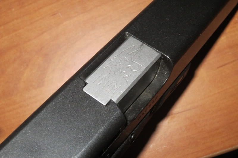

This being my first Glock I'll admit to little knowledge of the differences and options for models. I know the 20 and 21 share the same frame size and the 10mm & 45 barrels are supposedly the same OD but that's about it. So, I could buy a 21 long slide and use the ~ 6 inch 10mm threaded barrel with compensator? Anything different in the parts for the slide between the models? I'd rather have a complete slide to change for an easy swap back to OEM. Excuse my ignorance but even in my dotage I still try to learn. ;)
Yondering
Nothing wrong with asking questions here, fire away!
You're pretty much right on about the common parts between the 20 and 21. The extractor and safety plunger are different between the 10mm and 45 slides, and the 45 slide has a wider breech face. The only external difference between the 10mm and 45 barrels is the width of the barrel hood, which is supposed to locate the barrel side to side in the slide. With the 10mm barrel in a 45 slide, there is a gap on either side of the barrel hood, but the barrel is still located by the inner walls of the slide, so it works fine. The 45 extractor (in a 45 slide) works fine with 10mm, as long as it is the LCI (loaded chamber indicator) version. Extraction of the 10mm from the 45 slide is "different", in that it doesn't throw them all in the same direction, but it seems to be reliable, and I haven't had a problem with it.
I use my 10mm barrel in my RMR'ed G21 slide, or in my G20LS longslide. It shoots accurately and reliably either way. One caution note though - if using full power 10mm in a stock G21 slide, I strongly recommend using a muzzle brake. The 21 slide is lighter, and slide speed can be too high without a muzzle brake. The 21 longslide should be fine though, as it is still heavier than a stock 20 slide. I would get the solid top version if going with the 21 longslide, for the extra weight.
Here's mine, same frame and barrel as above, but in the 45 slide.
And a picture of the 10mm barrel hood in the 45 slide:
