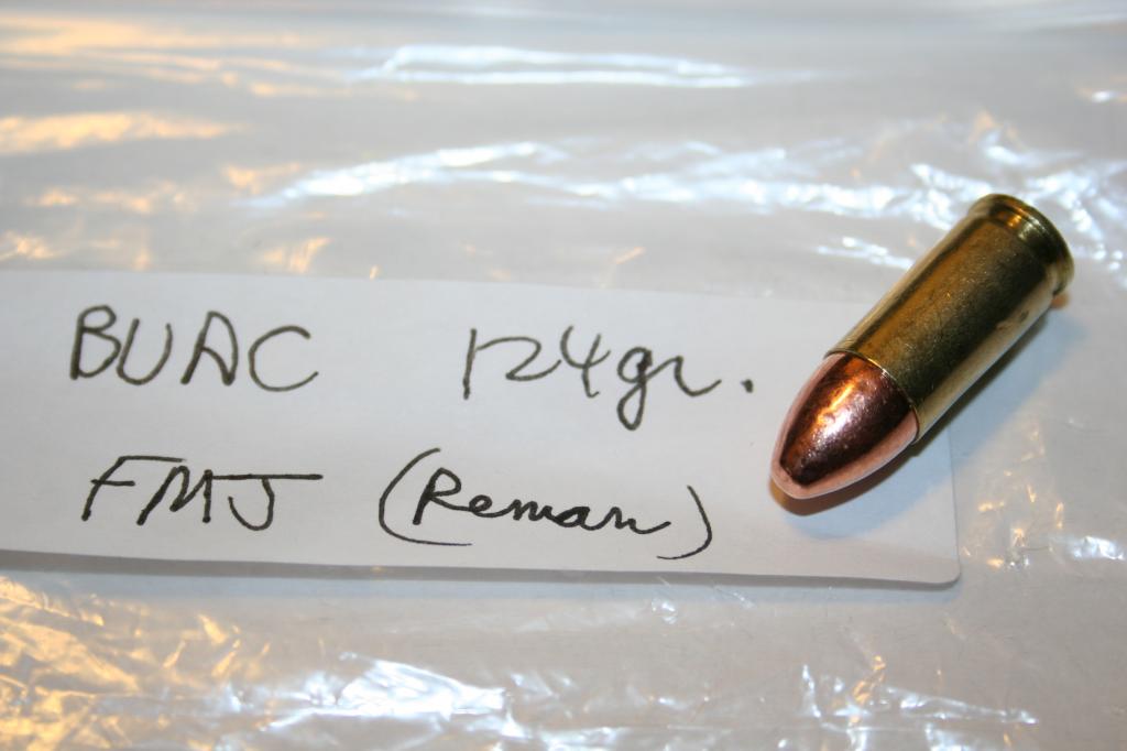

#150

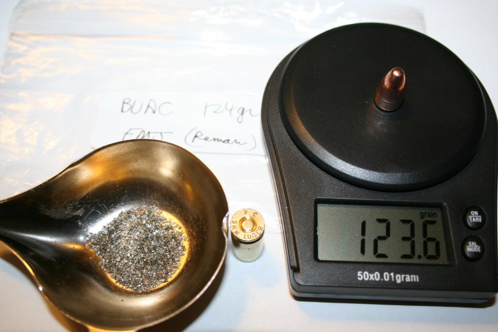

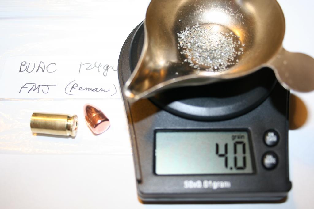

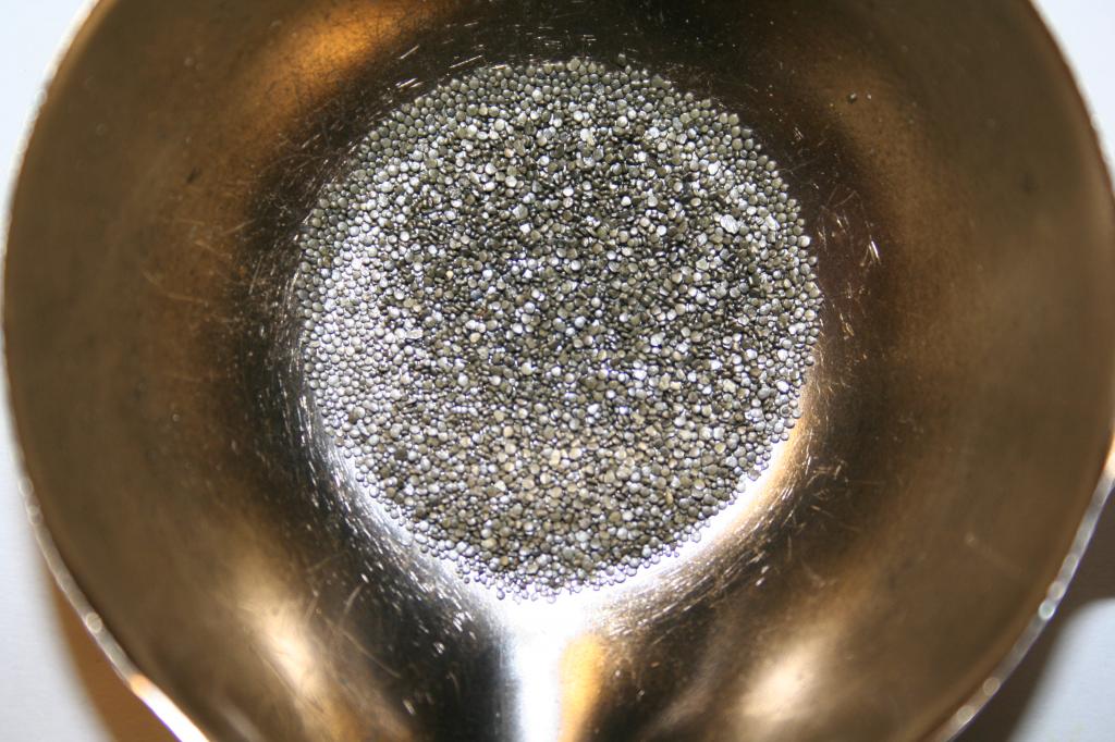

Cartridge is from Ammo Manufacture: Bitterroot Valley Ammunition & Components BVAC 124 gr FMJ
Ballistics Information: 9mm
Muzzle Velocity: N/A fps
Muzzle Energy: N/A ft. lbs
Brass Make/Headstamp: Federal FC – Brass (used)
Bullet Make/Weight/Construction/Info; Length 0.5940"/Dia. 0.3550": 124 gr. FMJ (plated)
Actual weight 123.6 grains (flat base) Crimp line 0.3545"
C.O.A.L.: 1.1525"
Primer: Brass color
Case: Diameter 0.3865" Crimp Diameter 0.3765" (light) Length 0.7490"
Powder Description/Positive ID/Type/Charge Weight:  ? WSF ?  4.0 grains *
BVAC loads both rounds. Makes sense seeing the same powder in both.

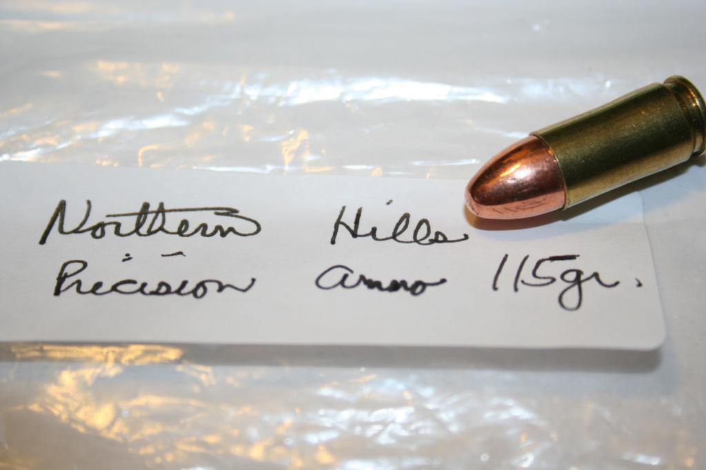

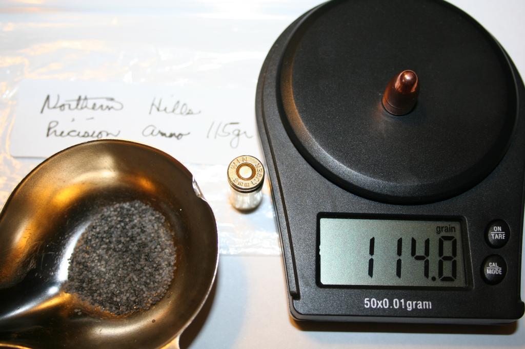

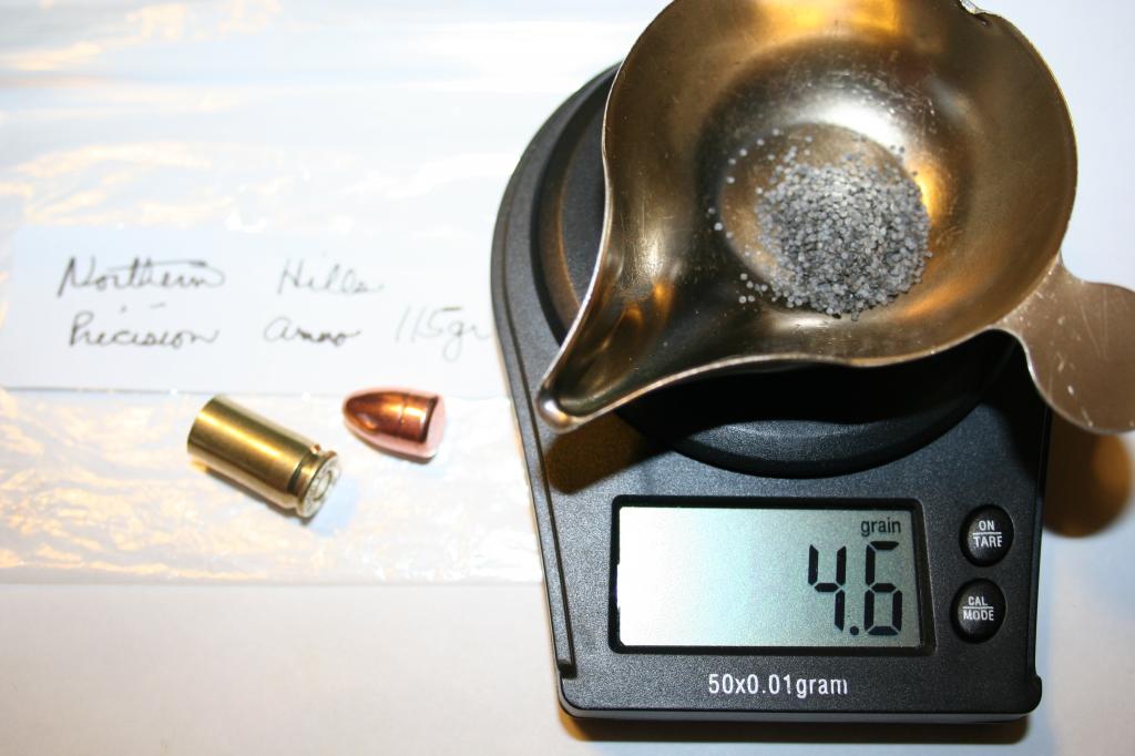

Cartridge is from Ammo Manufacture: Northern Hills Precision 115 gr FMJ
Brass Make/Headstamp: Winchester  WIN – Brass (used)
Bullet Make/Weight/Construction/Info; Length 0.5575"/Dia. 0.3550": 115 gr. FMJ (plated)
Actual weight 114.8 grains (flat base) Crimp line 0.3535"
C.O.A.L.: 1.1375"
Primer: Brass color
Case: Diameter 0.3875" Crimp Diameter 0.3780" (light) Length 0.7465"
Powder Description/Positive ID/Type/Charge Weight:  Alliant Bullseye  4.6 grains *
Tested by Intercooler
Springfield XD 4" 1149, 1171, 1185, 1194, 1151. Average = 1170 FPS/ 350 LBS
EAA Limited 4.75" 1190, 1211, 1210, 1226. Average = 1209.25 FPS/ 373 LBS

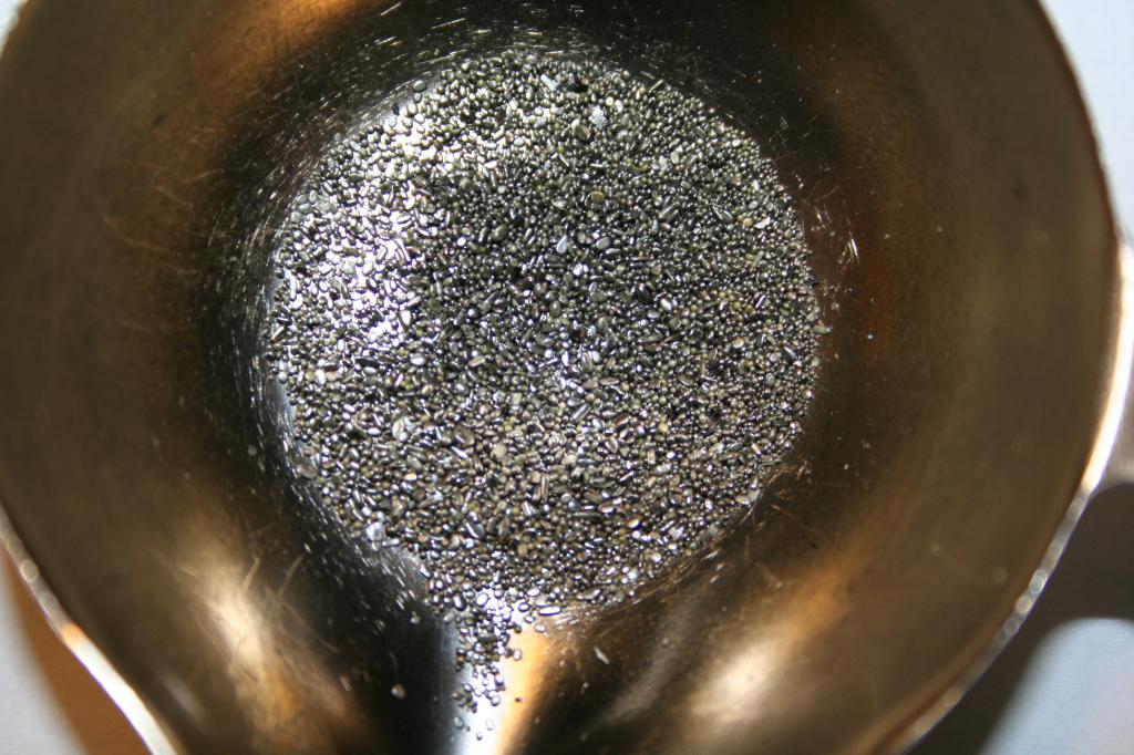

#153

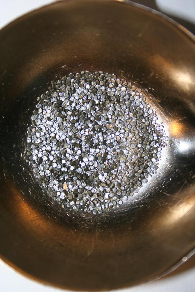

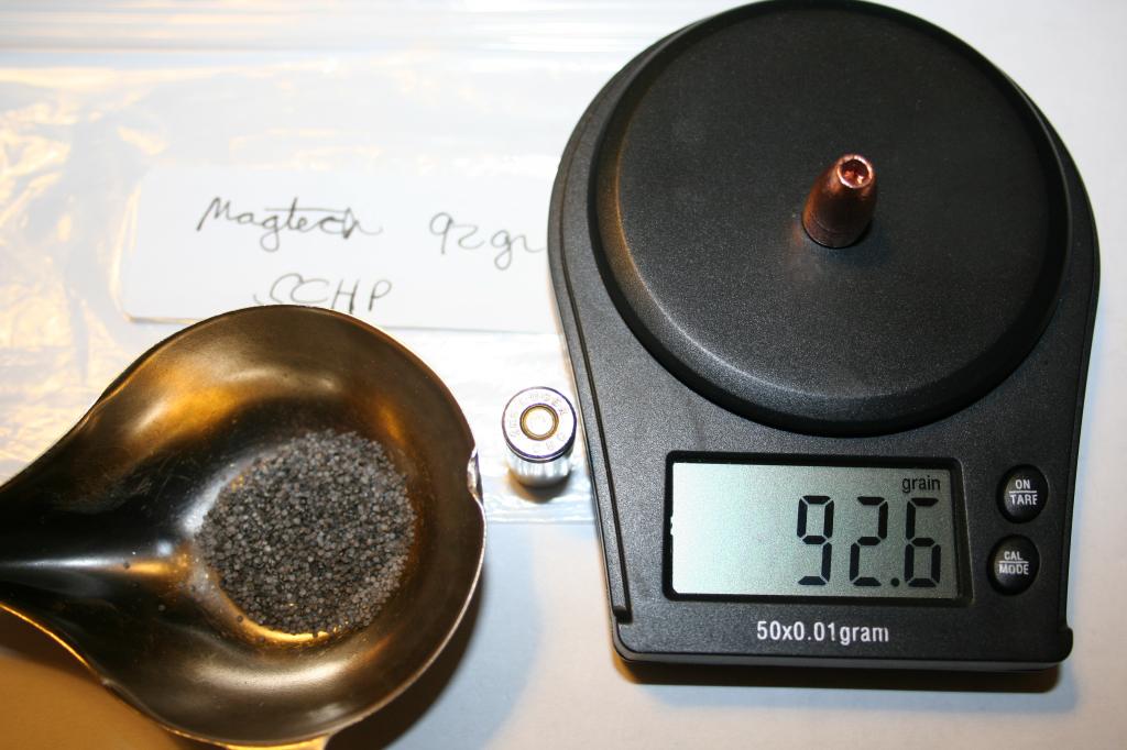

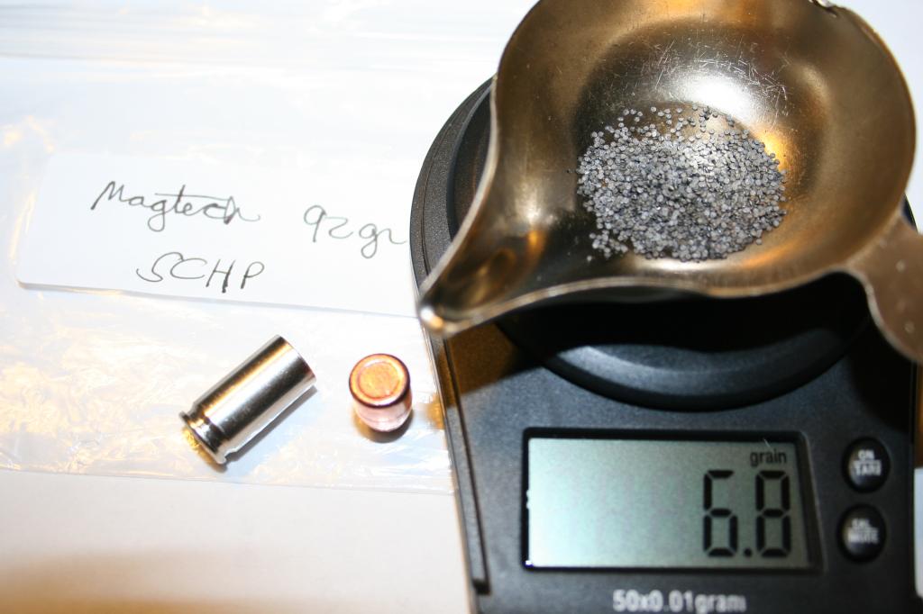

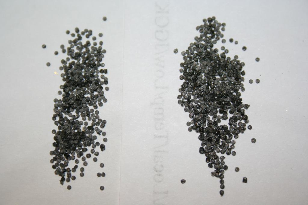

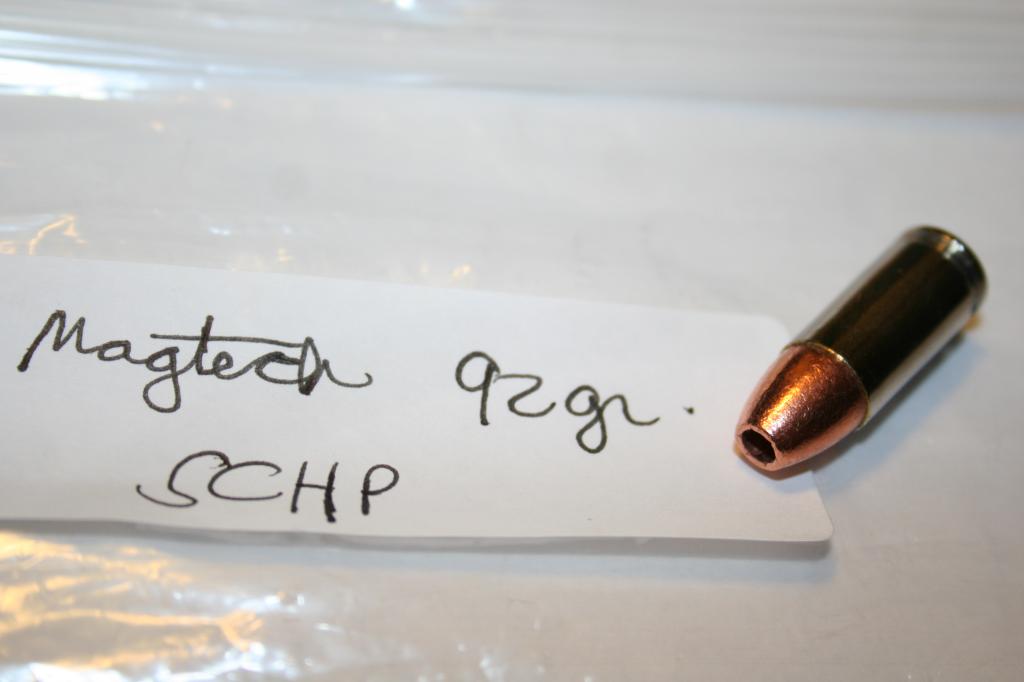

Cartridge is from Ammo Manufacture: Magtech 92.6 gr SCHP
Muzzle Velocity: 1330 fps
Muzzle Energy: 364 ft. lbs
Brass Make/Headstamp: CBC – Nickel
Bullet Make/Weight/Construction/Info; Length 0.5630"/Dia. 0.3535": Magtech 92.6 gr. SCHP
HP depth 0.3100" / HP dia 0.0940" / Mouth 0.1200"
Actual weight 92.6 grains (dimpled flat base) Crimp line 0.3520"
C.O.A.L.: 1.1100"
Primer: Brass color
Case: Diameter 0.3860" Crimp Diameter 0.3770" Length 0.7490"

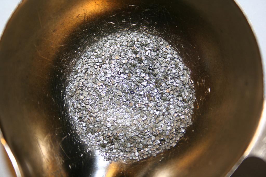

Powder Description/Positive ID/Type/Charge Weight: ? Power Pistol ?  6.8 grains *
*(reason for ? marks is Magtech does make their own powders)(powder had metal shavings in it) (similar to Power Pistol)
Magtech powder on the left and Power Pistol on the right...

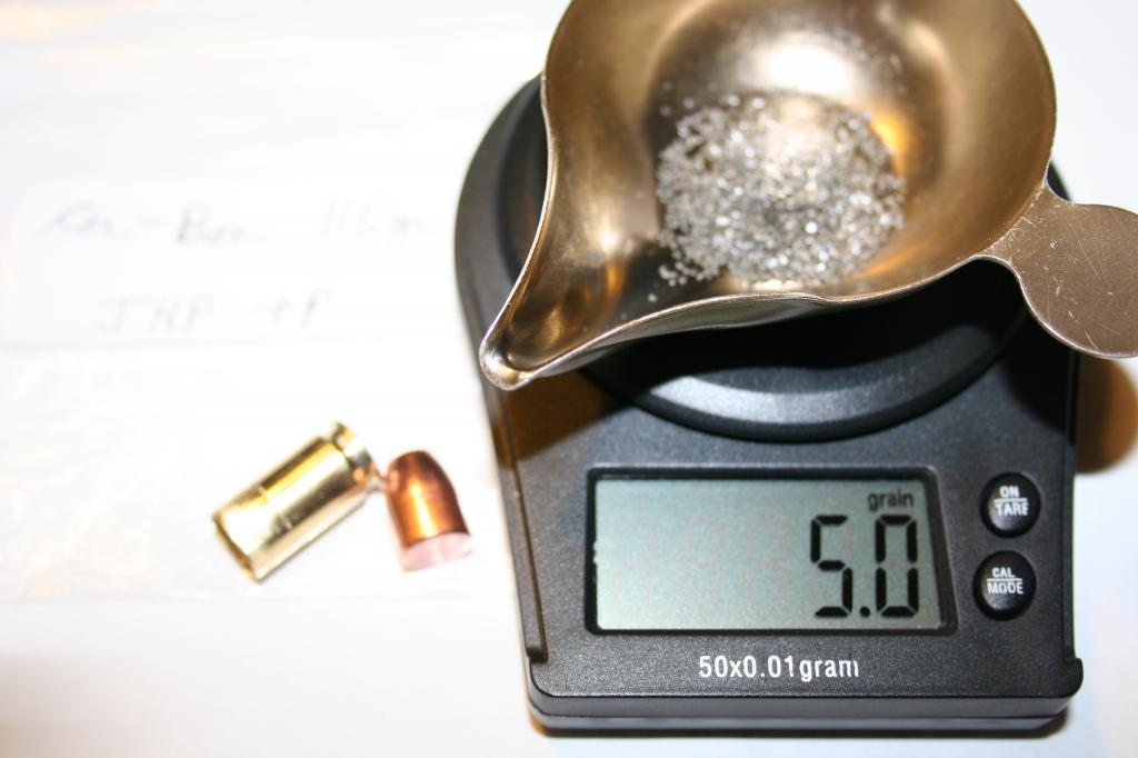

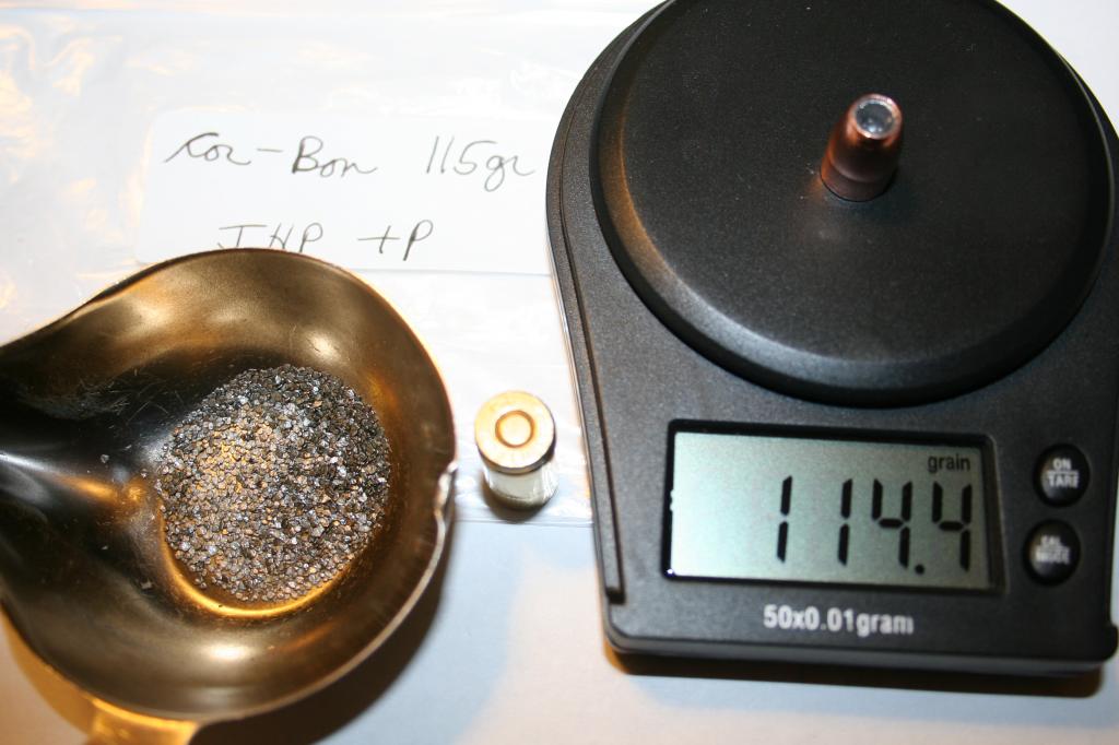

#154

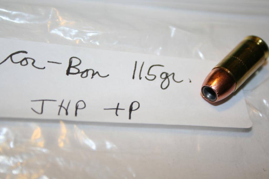

Cartridge is from Ammo Manufacture: Cor-Bon 115 gr +P  JHP
Ballistics Information: 9mm +P
Muzzle Velocity: 1350 fps
Muzzle Energy: 466 ft. lbs
Brass Make/Headstamp: Cor-Bon C-B – Brass ( has knurl line)
Bullet Make/Weight/Construction/Info; Length 0.4950"/Dia. 0.3545": ? 115 JHP
HP depth 0.1520" / HP cavity (tapered) 0.1500" / HP mouth 0.2500"
Actual weight 114.8 grains (flat base) Crimp line 0.3530"
C.O.A.L.: 1.0400"
Primer: Brass color
Case: Diameter 0.3865" Crimp Diameter 0.3760" Length 0.7490"
Powder Description/Positive ID/Type/Charge Weight:  Tight Group 5.0 grains
 Your pull-downs are beating the gel and velocity test nows  ;D
That's the advertised velocity and energy info...As I looked at the data for the Cor-Bon I think it's more like a 1225 fps loading.

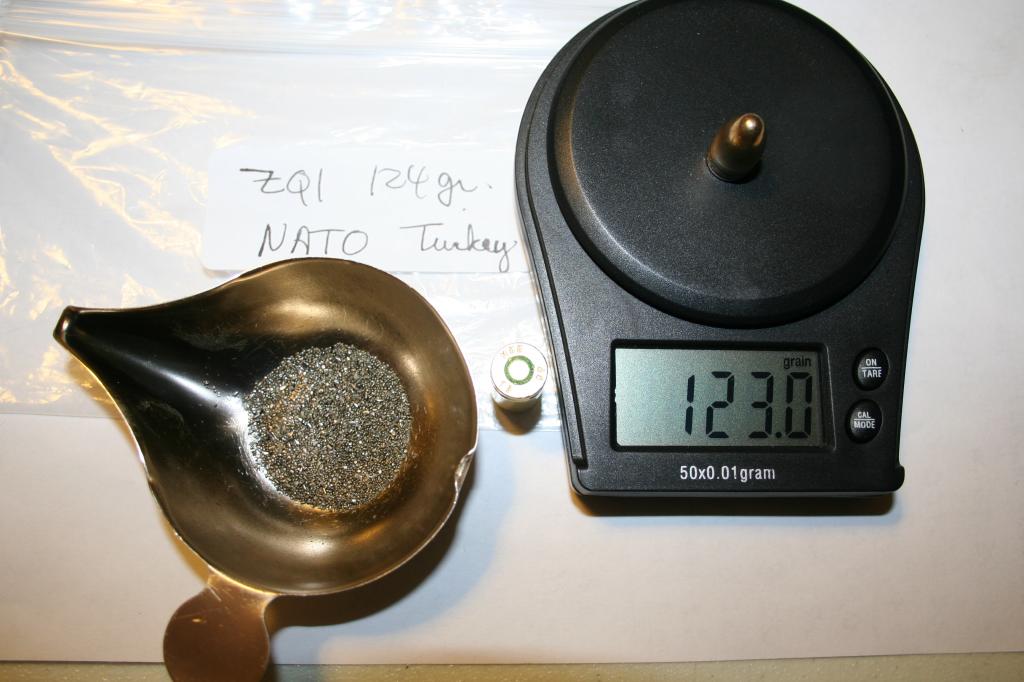

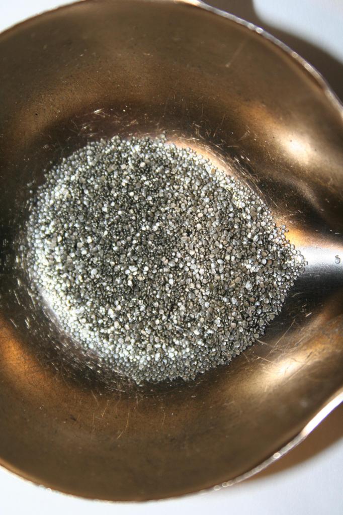

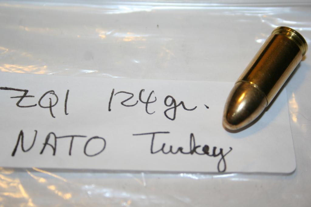

#157

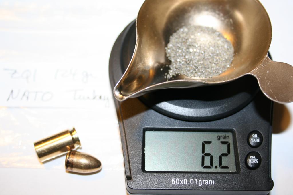

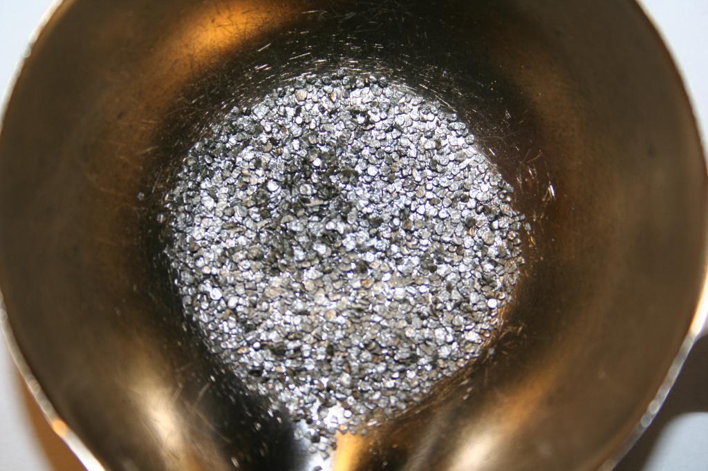

Cartridge is from Ammo Manufacture: MKE ZQ1 124gr FMJ NATO (Turkey)
Muzzle Velocity: 1200 fps
Muzzle Energy: 396 ft. lbs
Brass Make/Headstamp: MKE – Brass
Bullet Make/Weight/Construction/Info; Length 0.6110"/Dia. 0.3545": 124 gr. FMJ
Actual weight 123.0 grains (concaved exposed lead base)(black sealer) Crimp line 0.3515"
C.O.A.L.: 1.1630"
Primer: Brass color (green sealer crimped)
Case: Diameter 0.3885" Crimp Diameter 0.3755" Length 0.7490"
Powder Description/Positive ID/Type/Charge Weight:  ? ?  6.2 grains *
* (very fine irregular ball with tear drop/rod)(powder maybe LOVEX D032-04)
Modified to add the possible powder as LOVEX D032-04

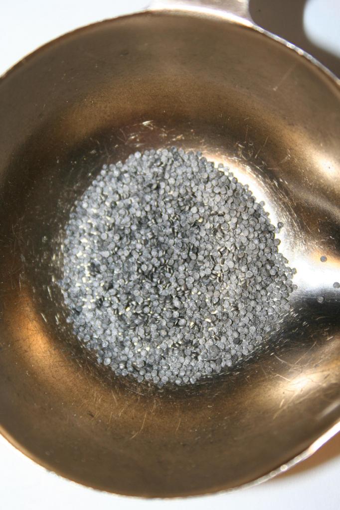

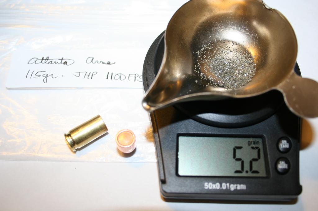

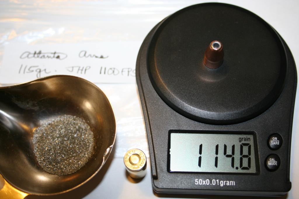

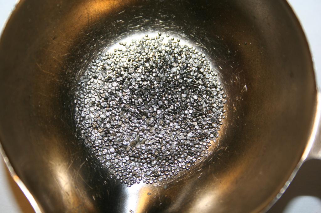

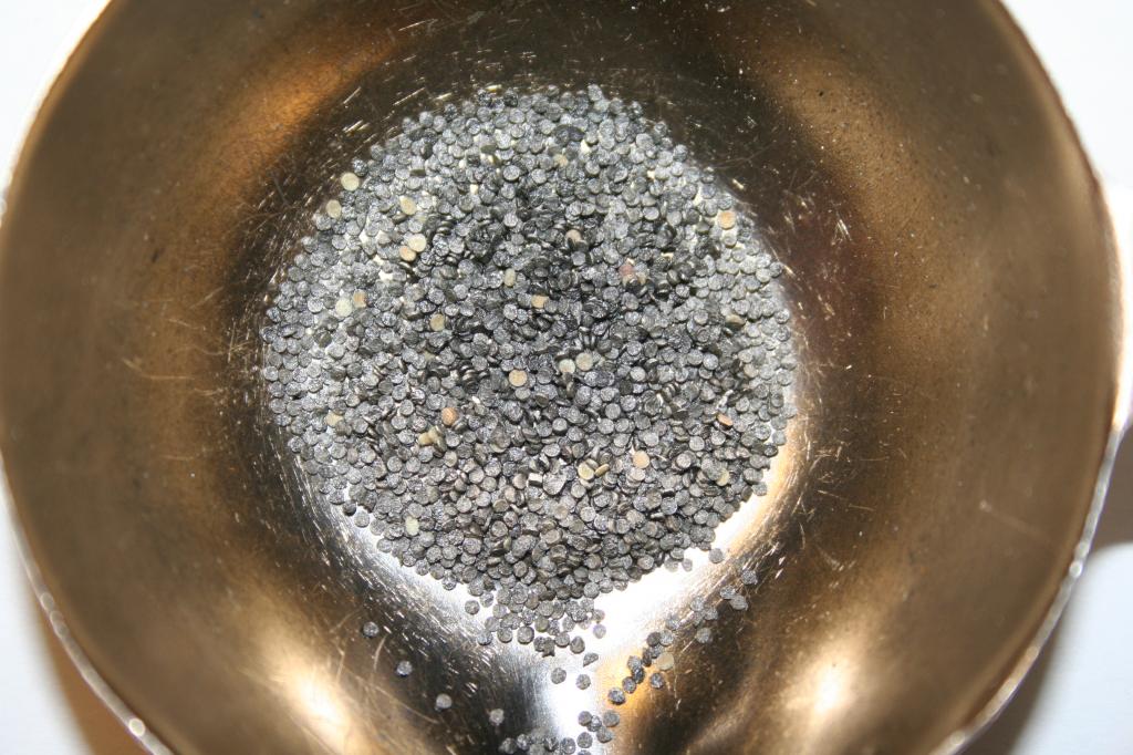

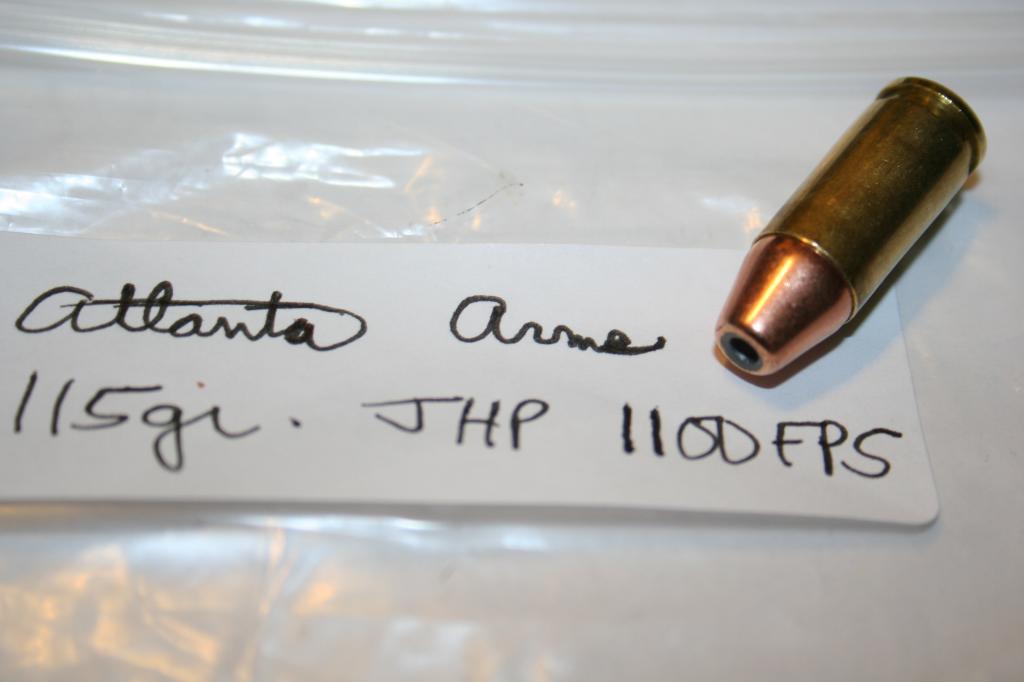

#159
Cartridge is from Ammo Manufacture: Atlanta Arms 115 gr JHP
Muzzle Velocity: 1100 fps
Muzzle Energy: 308 ft. lbs
Brass Make/Headstamp: Speer – Brass (used)
Bullet Make/Weight/Construction/Info; Length 0.5410"/Dia. 0.3550": 115 gr. JHP
HP depth 0.1480"  / HP 0.0875" cavity tapered  / HP Mouth 0.1840"
C.O.A.L.: 1.0745"
Primer: Brass color
Case: Diameter 0.3850" Crimp Diameter 0.3755" Length 0.7520"
Powder Description/Positive ID/Type/Charge Weight:  ? AA# 2 ?  5.2 grains *
(very fine flatten ball)

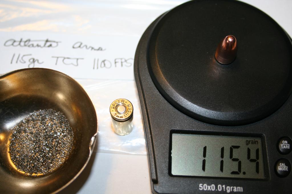

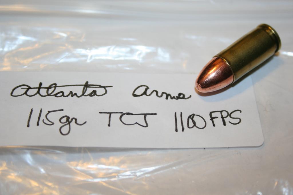

#160
Cartridge is from Ammo Manufacture: Atlanta Arms 115 gr TCJ
Bullet Make/Weight/Construction/Info; Length 0.5410"/Dia. 0.3550": 115 gr. TCJ
C.O.A.L.: 1.1365"
Primer: Nickel color
Case: Diameter 0.3835" Crimp Diameter 0.3775" Length 0.7520"
Powder Description/Positive ID/Type/Charge Weight:  AutoComp  5.2 grains

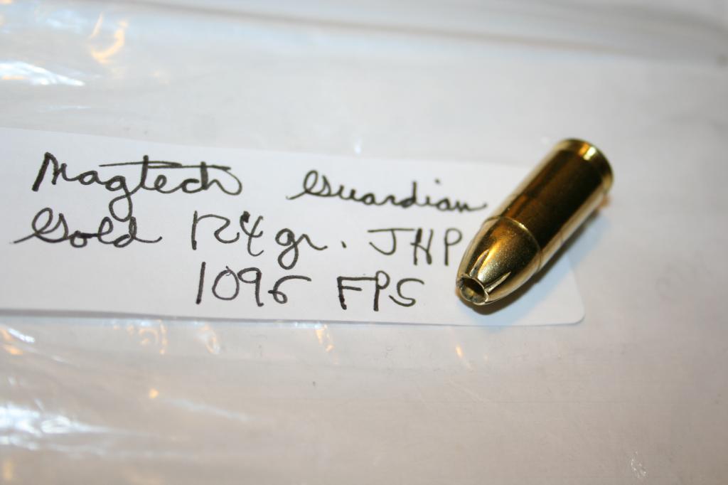

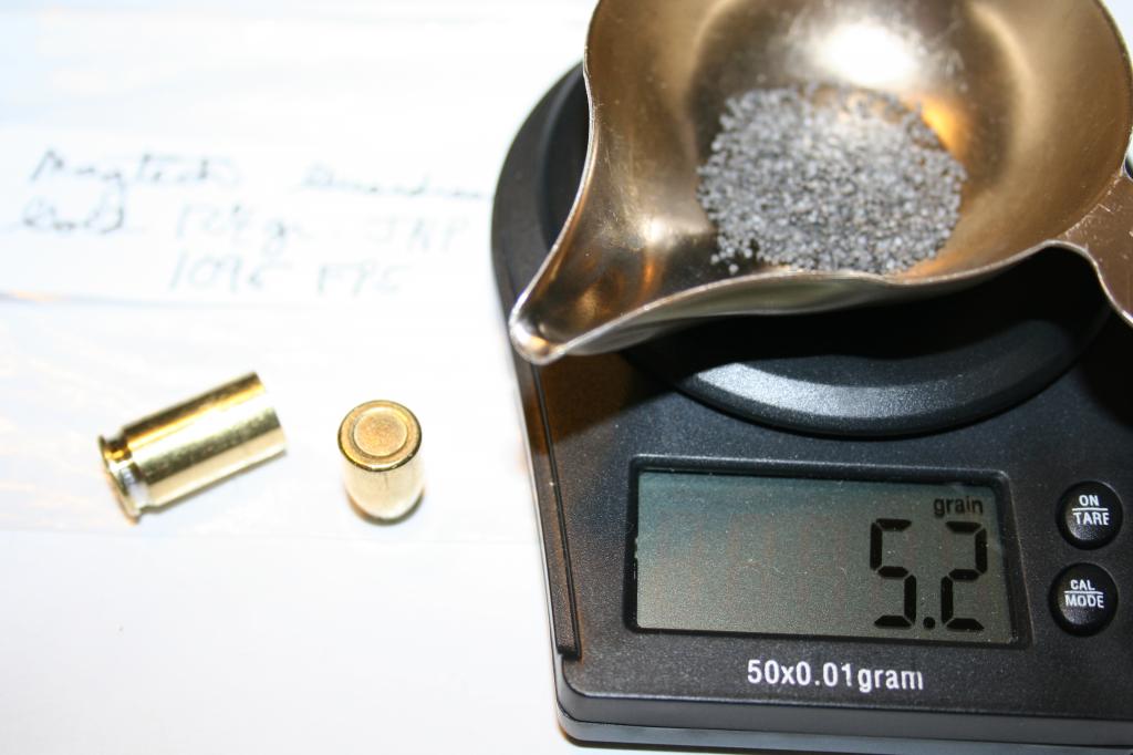

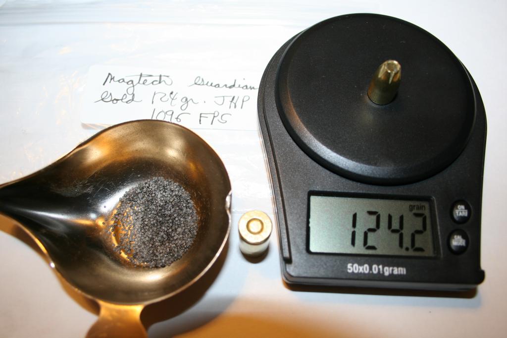

Cartridge is from Ammo Manufacture: Magtech Guardian Gold 124 gr JHP
Muzzle Velocity: 1096 fps
Muzzle Energy: 330 ft. lbs
Brass Make/Headstamp: CBC – Brass
Bullet Make/Weight/Construction/Info; Length 0.5815"/Dia. 0.3540": 124 gr. JHP
HP depth 0.2640" / HP dia 0.1180" (tapered) / Mouth 0.2140"
Actual weight 124.2 grains (dimpled flat base) Crimp line 0.3535"
C.O.A.L.: 1.1075"
Primer: Brass color
Case: Diameter 0.3860" Crimp Diameter 0.3770" Length 0.7475"
Powder Description/Positive ID/Type/Charge Weight: ? Power Pistol ?  5.2 grains *
*(reason for ? marks is Magtech does make their own powders) (similar to Power Pistol)

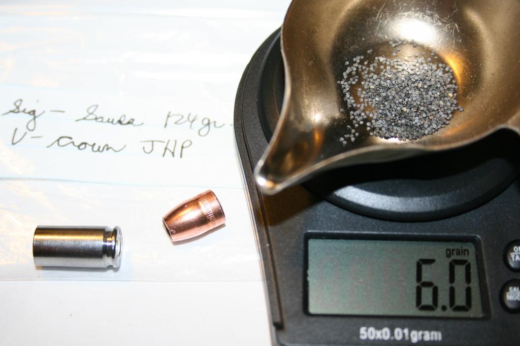

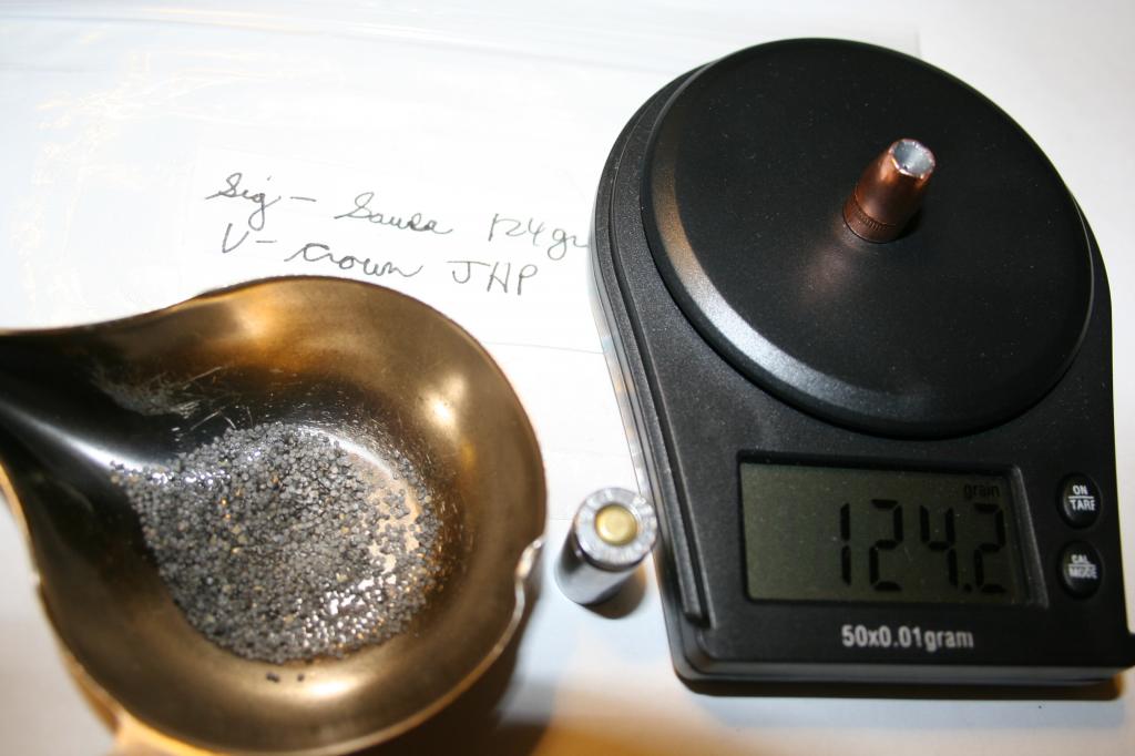

Cartridge is from Ammo Manufacture: Sig Sauer 124gr Speer V-Crown JHP
Muzzle Velocity: 1189 fps
Muzzle Energy: 389 ft. lbs
Brass Make/Headstamp: SIG – Nickel
Bullet Make/Weight/Construction/Info; Length 0.5355"/Dia. 0.3545": Sig 124gr. V-Crown JHP

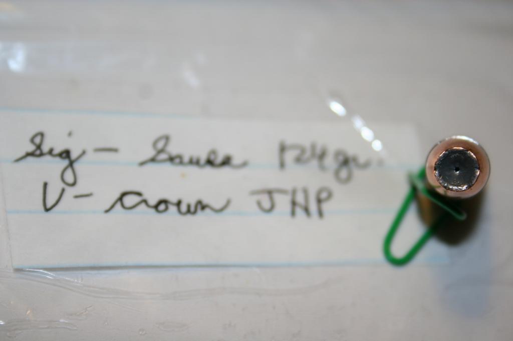

HP depth 0.1255" / *tiny secondary 0.1930" / HP 0.1580" tapered cavity / HP mouth 0.2570"
Actual weight 124.2 grains  (flat base) (has shallow cannelure 0.3515") crimp line 0.3490"
C.O.A.L.: 1.0990"
Primer: Brass color
Case: Diameter 0.3860" Crimp Diameter 0.3735" Length 0.7520"

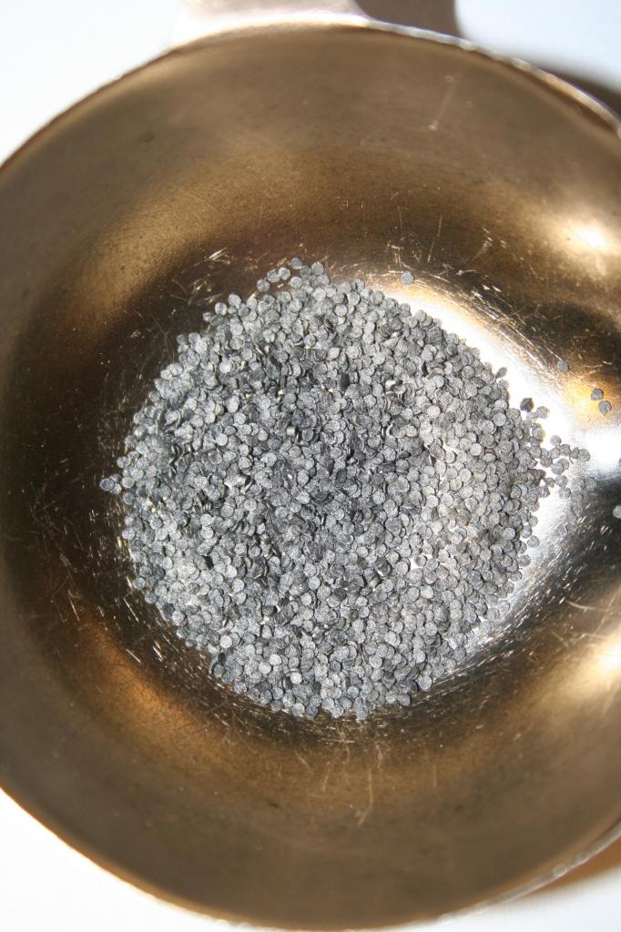

Powder Description/Positive ID/Type/Charge Weight: BE-86 6.0 grains **
** (similar to Power Pistol fine flat flake with lighter tan colored slightly larger flakes identifiers)
* (tiny secondary hole deeper than the main cavity 0.1930")
Sig-Sauer 124gr V-Crown
Springfield XD 4" 1174, 1224, 1202, 1178. Average = 1194.5 FPS/ 393 LBS
EAA Elite Limited 4.75" 1223, 1250, 1245, 1267. Average = 1246.5 FPS/ 428 LBS

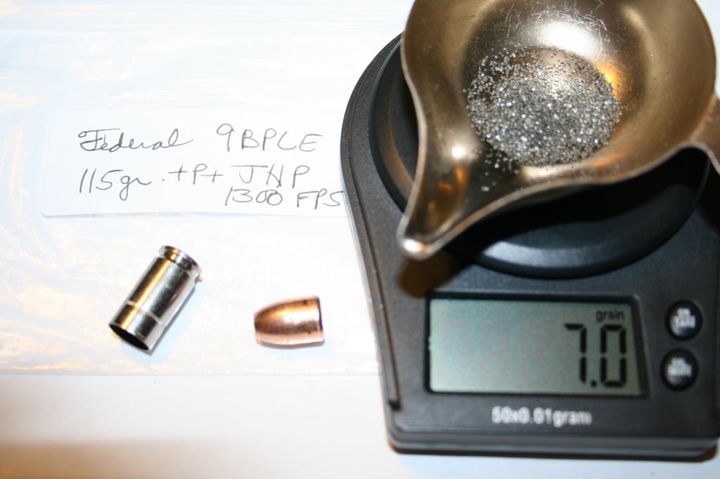

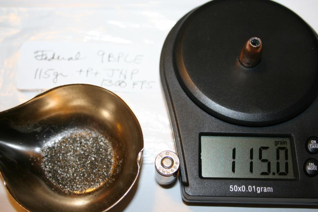

#163
Cartridge is from Ammo Manufacture: Federal 9BPLE 115gr +P+ Hi-Shok JHP bullets
Muzzle Velocity: 1300 fps
Muzzle Energy: 431 ft. lbs
Brass Make/Headstamp: Federal Cartridge – Nickel +P+
Bullet Make/Weight/Construction/Info; Length 0.5250"/Dia. 0.3545": FED 115gr. JHP
HP depth 0.2500" / HP dia 0.1010" (tapered) / HP mouth 0.2150"  Six long segments
Actual weight 115.0 grains   (flat base) (crimp line 0.3535") (small amount black sealant)
C.O.A.L.: 1.0955"
Case: Diameter 0.3850" Crimp Diameter 0.3760" Length 0.7485"
Powder Description/Positive ID/Type/Charge Weight: ? Silhouette ? 7.0 grains *
(fine flattened ball)

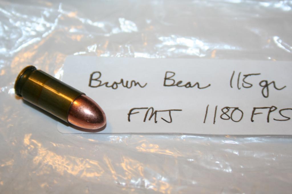

#164

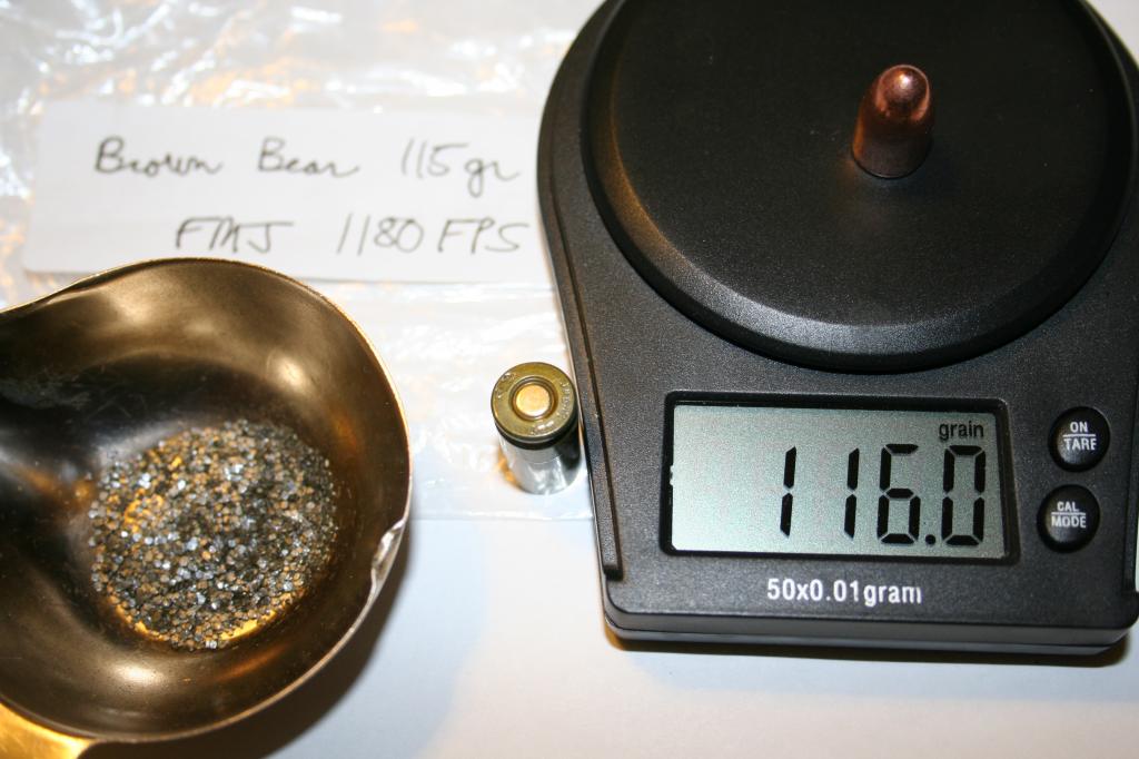

Cartridge is from Ammo Manufacture: Brown Bear 115gr FMJ
Muzzle Velocity: 1180 fps
Muzzle Energy: 355 ft. lbs
Brass Make/Headstamp: Barnaul Machine Plant (cartouche) – Coated Steel
Bullet Make/Weight/Construction/Info; Length 0.6025"/Dia. 0.3545": 115 gr. FMJ
Actual weight 116.0 grains (concaved exposed lead base) Crimp line 0.3540"
C.O.A.L.: 1.1185"
Primer: Brass color (Berdan)
Case: Diameter 0.3880" Crimp Diameter 0.3780" Length 0.7450"
Powder Description/Positive ID/Type/Charge Weight:  ? HP-38/231 ?  5.0 grains *
(very fine flatten ball/flake)
