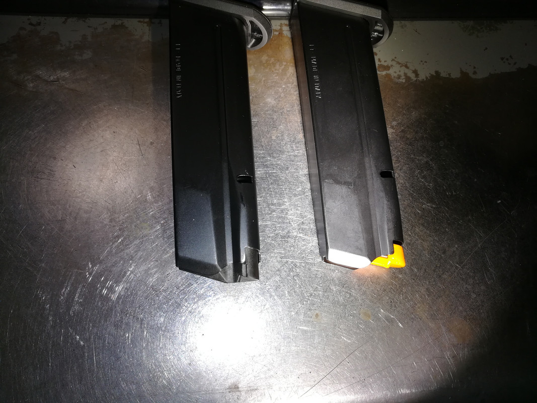

My new mag came in today. I can see the difference in the followers. It's made by EAA and considered a replacement mag for the pistol.
I'll head to the range tomorrow and see how it goes. Old left, new right.
How powerful is 10mm? Well, see those craters on the moon?
Olgo
Didn't do any better. I guess it takes time to break in. Also the new mag doesn't hold the slide open.

Sent a note to EAA site about the FTFs and they replied that they want pics of the mags. I sent 6 pics of two mags I have.
Then I went to the range to shoot the 40sw ammo. Shot a lot better but still had a few FTFs. I noticed that sometimes the rounds are straight to the chamber but not going to battery. When I pulled the mag out it went to battery.
It seems that the mags are a bit too tall that the slide catches on it.
When I got home EAA wanted me to send in the mags or they can send me a follower. They said an attachment is included for me to fill out but it's not there. I just replied to send me the follower. I doubt that'll work though.

Got the new follower and it's different. May do the trick. Don't know when I'll go to the range, probably not til next month.
Here's the pics, new on left old (came with gun) on right.
Olgo
My EAA Witness P 10mm ready for duty sir!  :D
Yep, it was the follower. The one EAA sent worked without a hitch, both 10mm and 40sw. Even it sounded different. Before it was Snick... Snack now it's Zip every time.
