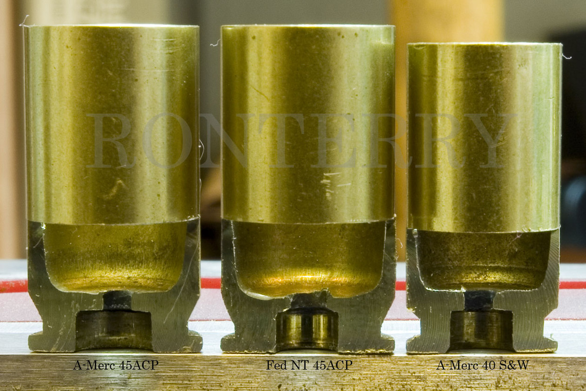

But I do have a case sizer, and some cases that measure long The sizer won't touch to cut, the inside depth is different. That volume difference could matter.

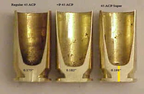

There are probably some differences between makers.  PLUS P 45 is said to have a slightly thicker side web as per Starline.  Not so for 9mm, but be aware of the 9mm that has that shoulder down inside the case...
Also there are many small pistol primer 45ACP out there to watch for.  Here are some pics I had on hand.
