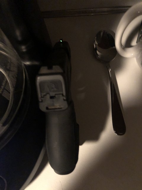

Hey Ken I just bought a Taurus GX4 from a big sale at my range and it is really a carbon copy of my G2 Mallineum without the safty. My question for you is abou the trigger pull. Mine is very hard but I compared it to other gx4 and they are all very hard on the pull. How is yours? I do think since it's just for carry it is OK and super safe!!  Craig
Morning Craig, it is, but has a very distinct wall. On mine, you know exactly when it will go bang, unlike many polymer pistols that haven?t any wall. For a pistol in the mid $200.00 range, it?s tough to beat. I have read several articles regarding trigger issues on the GX4, primarily on the early released ones. It appears that either it?s a good one, or it?s not. Also, the 10 and 11 rd mags seem to work well, but have read about problems with the 13 rd mags. I did do a couple of minor upgrades on the GX4, the Night Fision big dot front sight (left the rear sight alone) from Lakeline, and a Houge HandAll grip sleeve. Houge didn?t make a HandAll for the GX4 when I got mine, so I spoke with an engineer at Houge, and he said the best fit for that weapon was the Ruger Security-9 Compact, which fit perfectly once I got the darn thing on. Good luck, and enjoy your GX4
