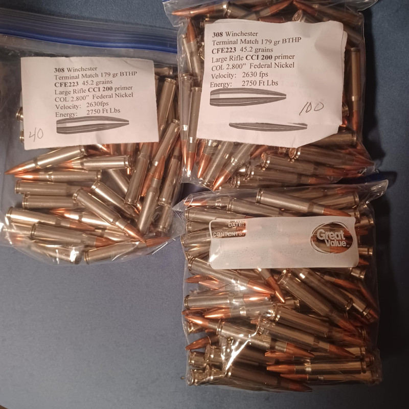

Well had a little time and sat down and got all the 308Win loaded with the 179 grain Terminal Match bullets.
Here are the specs I went with:
308 Winchester
Terminal Match 179 gr BTHP
CFE223  45.2 grains
Large Rifle CCI 200 primer
COL 2.800"  Federal Nickel
Velocity: 2630 fps(estimated from 24" BBL data)
Energy:   2750 Ft Lbs
Total powder used 1.640114285714286 lbs
I forgot to post the finished work, this was 240 in Federal brass, have 13 more in Hornady brass not shown.

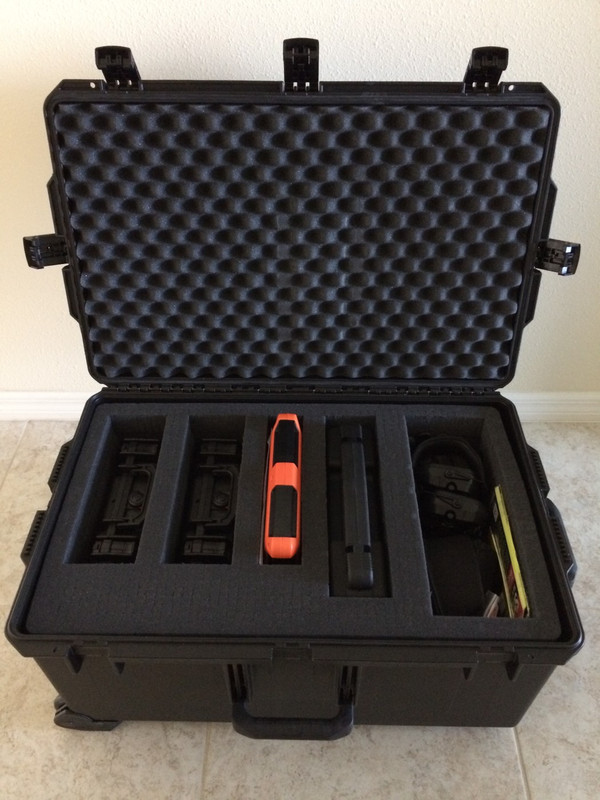

At one point I ordered countless ammo boxes from the same brand, for all my calibers. Not even my dirty range brass gets the zip-lock treatment - only the random brass finds I don't shoot at all.  ;D
My OCD brain won't shut up lol
Heck, I have Pelican cases for my Pelican cases!
Well I did take the ziplock bags out of the military steel ammo can to take the picture.
