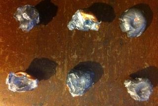

Got to the land this weekend and shot some of the Speer 200gr GDHP at 1050 fps and 1180 fps into wetpack and 4 layers  of denim. Even at 1050 fps the petals sheared off of the bullets  ???.
I am starting to wonder if the marks on the bullets (where the machine clamped onto the bullet to pull them ) went in deeply enough to effect the performance.
Top row 200gr GDHP at 1180 fps-Weights=184.3-196.3- 198.5
Bottom 200gr GDHP at 1050 fps- Weights = 193.6 -197.3- 185.8
Sean
Quote from: 475/480 on September 03 2013 10:32:23 AM MDT
That is what I suspected looking over the samples ROME had sent me to test...Jello-Shots (pun intended) :)) may show a better observation and performance.
Thanks for posting your results from the wet pack, the bullets will still make a nasty wound judging for the results. :o

475/480
FWIW : Penetration was 8"-9" in the wetpack.
Sean
Raggedyman
Thank you. So it looked like the penetration was similar to without denim? In water and gelatin I usually see less penetration without denim. I believe that is because the bullet opens earlier and wider without the denim plug.
