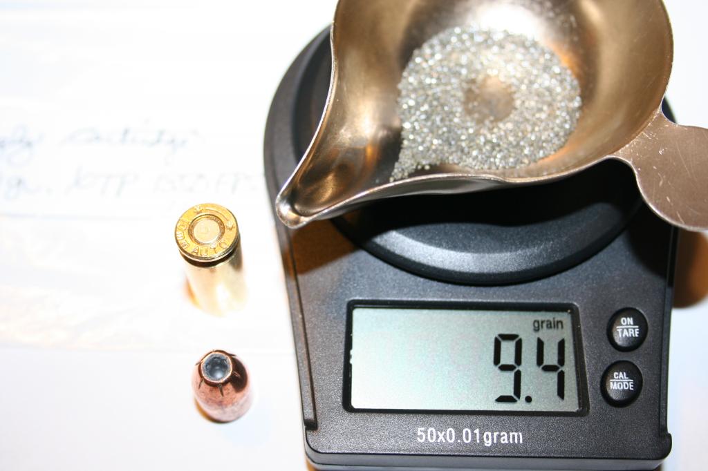

Cartridge is from Ammo Manufacture: Grizzly Cartridges 180 grain Hornady XTP
Muzzle Velocity: 1350 fps
Muzzle Energy: 728 ft. lbs
Brass Make/Headstamp: Star Line – Brass
Bullet Make/Weight/Construction/Info; Length 0.6215"/Dia. 0.4000": 180 grain Hornady XTP
Actual weigh 180.4 grains  Crimp Diameter 0.4000"
HP depth  HP 0.1405" / HP dia. 0.1160" / mouth 0.2350"
C.O.A.L.: 1.2440"
Primer: Nickel color
Case: Diameter 0.4215" Crimp Diameter 0.4220" (medium) Length 0.9875"

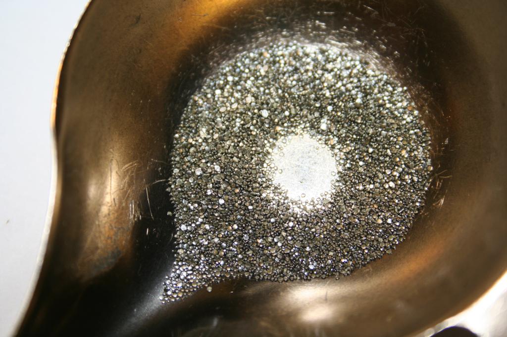

Powder Description/Positive ID/Type/Charge Weight: ? AA#5 ?  RamShot Silhouette ? 9.4 grains
Silvery flattened ball and flake
Looks like the Crossfire? Used more often than we thought!
