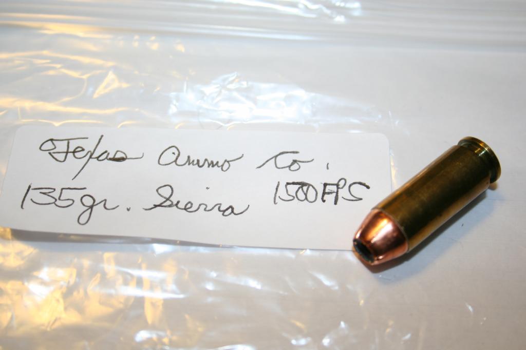

Cartridge is from Ammo Manufacture: Texas Ammo 135gr JHP Sierra
Muzzle Velocity: 1500 fps
Muzzle Energy: 674 ft. lbs
Brass Make/Headstamp: Star Line - Brass

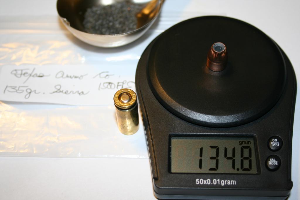

Bullet Make/Weight/Construction/Info; Length 0.4910"/Dia. 0.4000": 135gr. JHP
Actual weight 134.8 grains   Crimp squeezed bullet to 0.3955"
HP depth 0.2060" / HP dia 0.1230" / mouth dia 0.2310"
C.O.A.L.: 1.2525"
Primer: Nickel color
Case: Diameter 0.4215"" Crimp Diameter 0.4210" (tight) Length 0.9880"

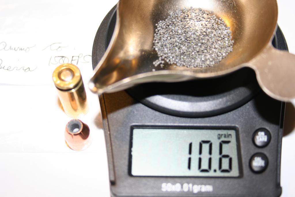

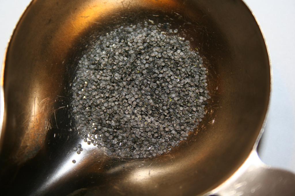

Powder Description/Positive ID/Type/Charge Weight: Power Pistol  10.6 grains
