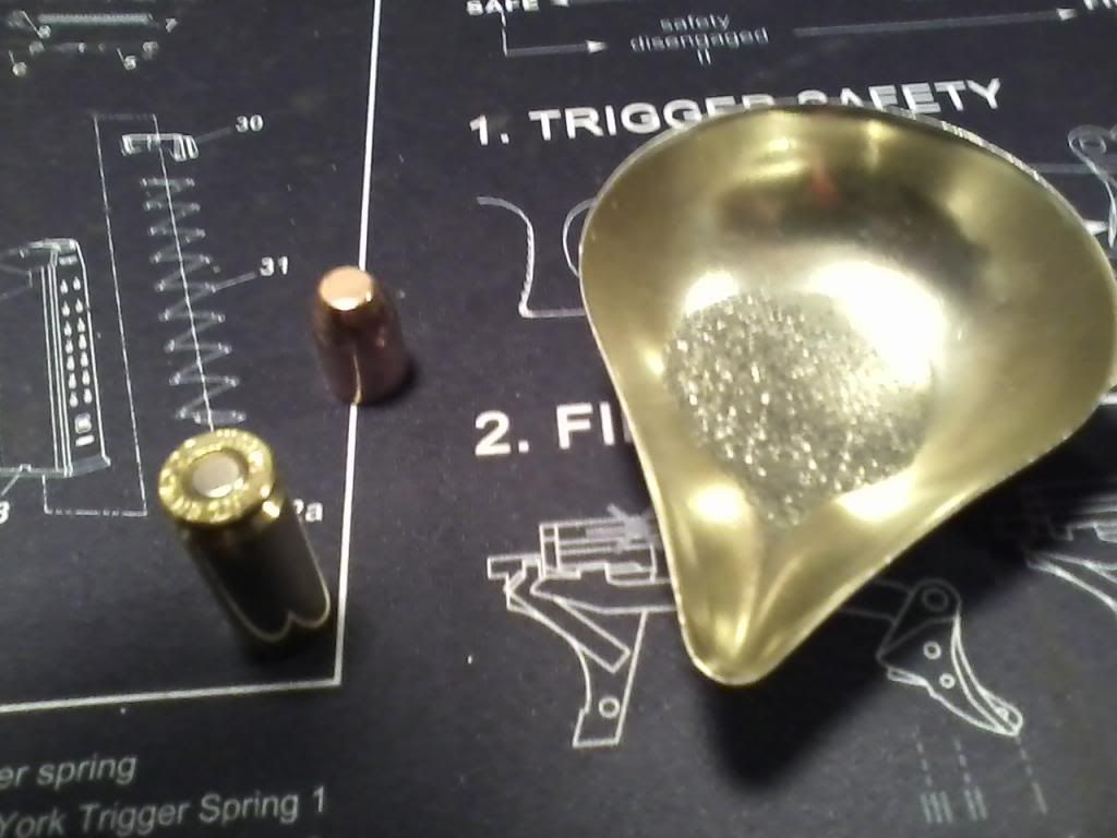

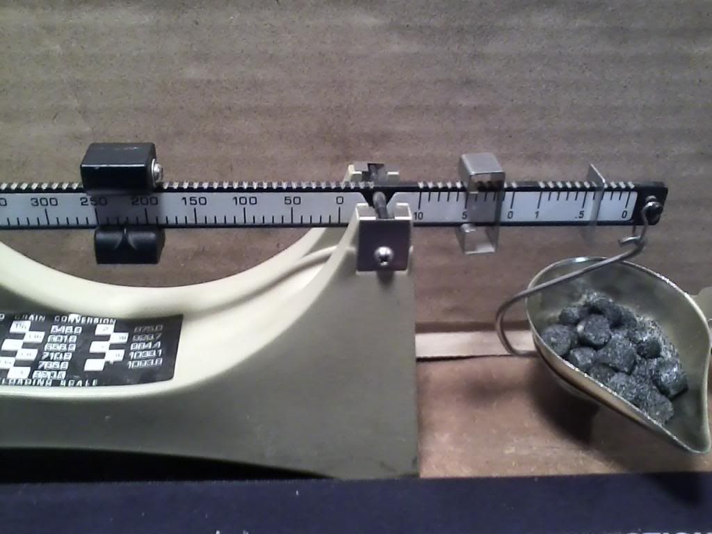

OK,  So I got 20 of the BB 155 Tac-x's and 5 of the Underwood 180 TMJ's pulled down this afternoon.   I'm a little under the weather today and Snow is forecast for tomorrow and Saturday, so I will finish the pulldowns later.   Anyway, here is what I got using an RCBS Kinetic Bollet Puller and an Ohaus 505 Balance Beam Scale.
The Buffalo Bore 155 Tac-x:
Brass Case:  Head Stamp - A USA 10mm Auto ( Appears New )
Primer: Silver Large Pistol
Bullet: Barnes 155 Tac-x ( Copper/ Lead Free HP )
   Muzzle Velocity from BB Web Site -  1425 FPS from stock G20
Powder Charge: I weighed 5 random during the pulldown, finding charges of 11.3, 11.2, 11.2, 11.2 & 11.2 grains of an unknown powder that was so compressed it looked like a pellet.
20 charges weighing 222.6 grains average of 11.13
The Underwood 180 TMJ:
Brass Case:  Head Stamp - Underwood 10mm ( Appears New )
Primer- Silver Large Pistol
Bullet - 180 Grain Truncated Cone with a dished base ( Appears similar to the Xtreme HPCB )
   Muzzle Velocity from Underwood Web Site - 1300 FPS
Powder Charge: All 5 weighed 14.4 Grains, Unknown Powder ( Fine Texture & didn't appear
       to have been Compressed )
I tried attaching a picture and found the file was too large .....   :-[

Last time I pulled the Buffalo Bore 155 TAC XP, I found the compressed pellet of Power pistol powder 11.0 grain in charge weight.
This info is posted here; http://10mm-firearms.com/factory-10mm-ammo-pull-downs/buffalo-bore-barnes-155gr-tac-xp-pull-down/
The Underwood 180 TMJ's seems to have a slightly different powder charge in your pull-down and that charge weight seems to lead me to Accurate Arms #9 but it is possible it may be something else.  Don't know without visual confirmation.

I modified and added the Pictures for Mtnfolk75 post... 8)
