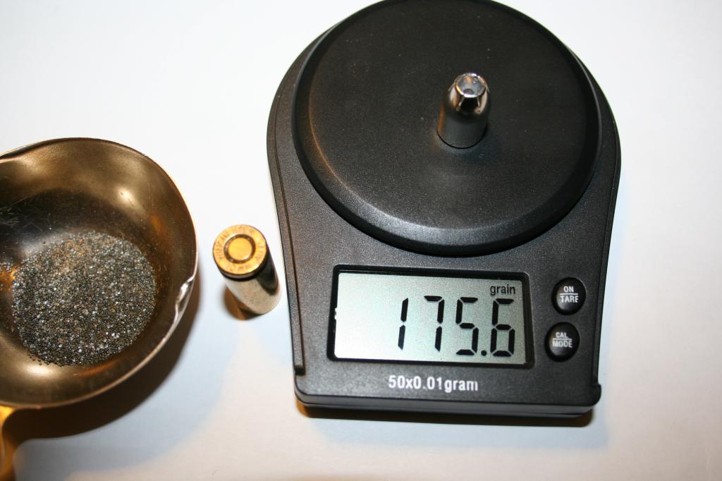

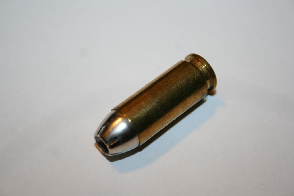

Cartridge is from Ammo Manufacture: Winchester 175gr SilverTip JHP (1/15/2015 provided by Intercooler)
Muzzle Velocity: 1290 fps ?
Muzzle Energy: 649 ft. lbs ?
Brass Make/Headstamp: Winchester - Brass
Bullet Make/Weight/Construction/Info; Length 0.6160"/Dia. 0.4005": 175gr. SilverTip JHP
HP depth 0.3000" / inside Dia. 0.1600" tapered / mouth Dia. 0.2400"
Actual weight 175.6 grains   Crimp squeezed bullet to 0.3990"
C.O.A.L.: 1.2580"
Case: Diameter 0.4215" Crimp Diameter 0.4210" (Tight) Length 0.9860"

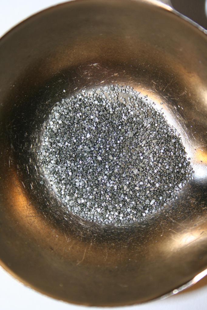

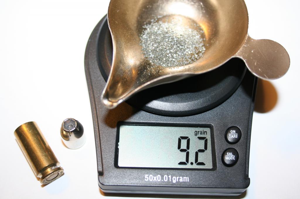

Powder Description/Positive ID/Type/Charge ?? WAP ?  Weight: 9.2 grains*
*Appears to be a factory loading...(flatten ball)(powder had some brown dust)

That was a cheap clearance Frankford Arsenal scale $29, it can fluctuates and needs rezeroing constantly, and only shows the even numbered tents 0.0, 0.2, 0.4, 0.6, 0.8   While it finds unknown weights fast and somewhat accurately to the even number 1/10's I would not use this to load with...  I use my Beam Scale because it is much better for very precise powder charges.
I do use this digital to verify what the bean scale is showing and they do match up.
There are other digital scales that are probably better suited than this one.
