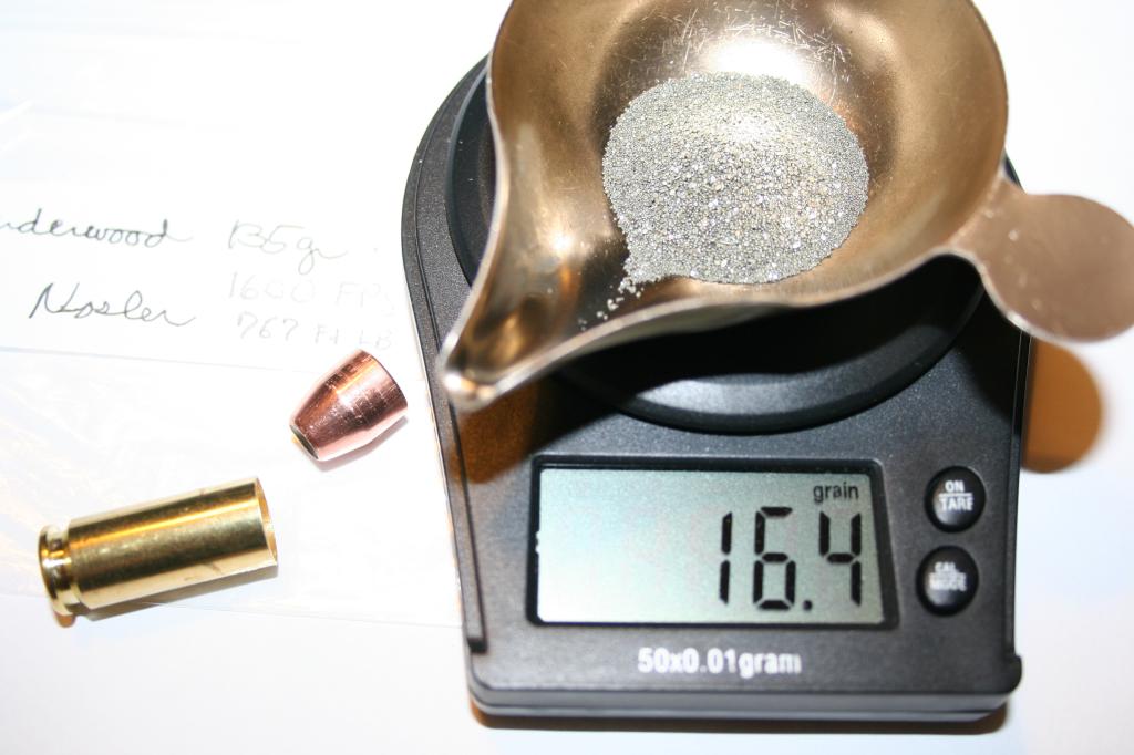

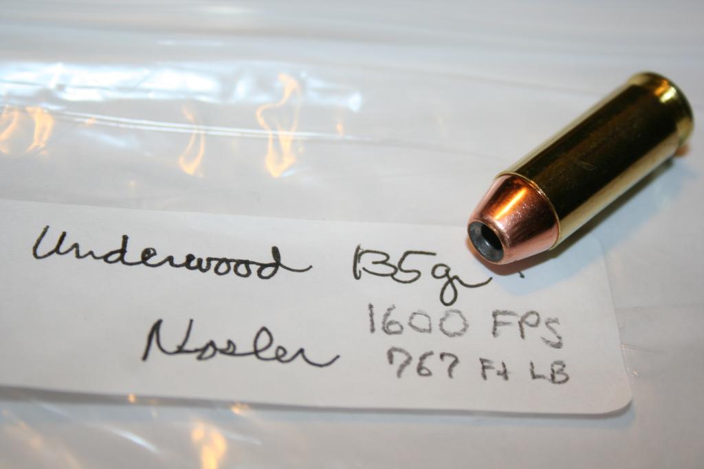

Cartridge is from Ammo Manufacture: Underwood 135gr Nosler JHP (3/4/2015)
Muzzle Velocity: 1600 fps
Muzzle Energy: 767 ft. lbs
Brass Make/Headstamp: Underwood - Brass
Bullet Make/Weight/Construction/Info; Length 0.4915"/Dia. 0.4000": Nosler 135gr. JHP
HP depth 0.2040" / HP dia 0.1800" (tapered) / HP mouth 0.2550" (crimp ring 0.3985")

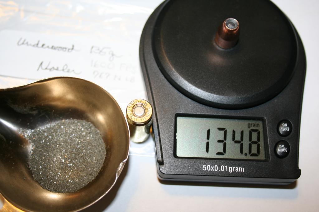

Actual weight 134.8 grains  (flat base)
C.O.A.L.: 1.2500"
Case: Diameter 0.4220" Crimp Diameter 0.4230" Length 0.9870"

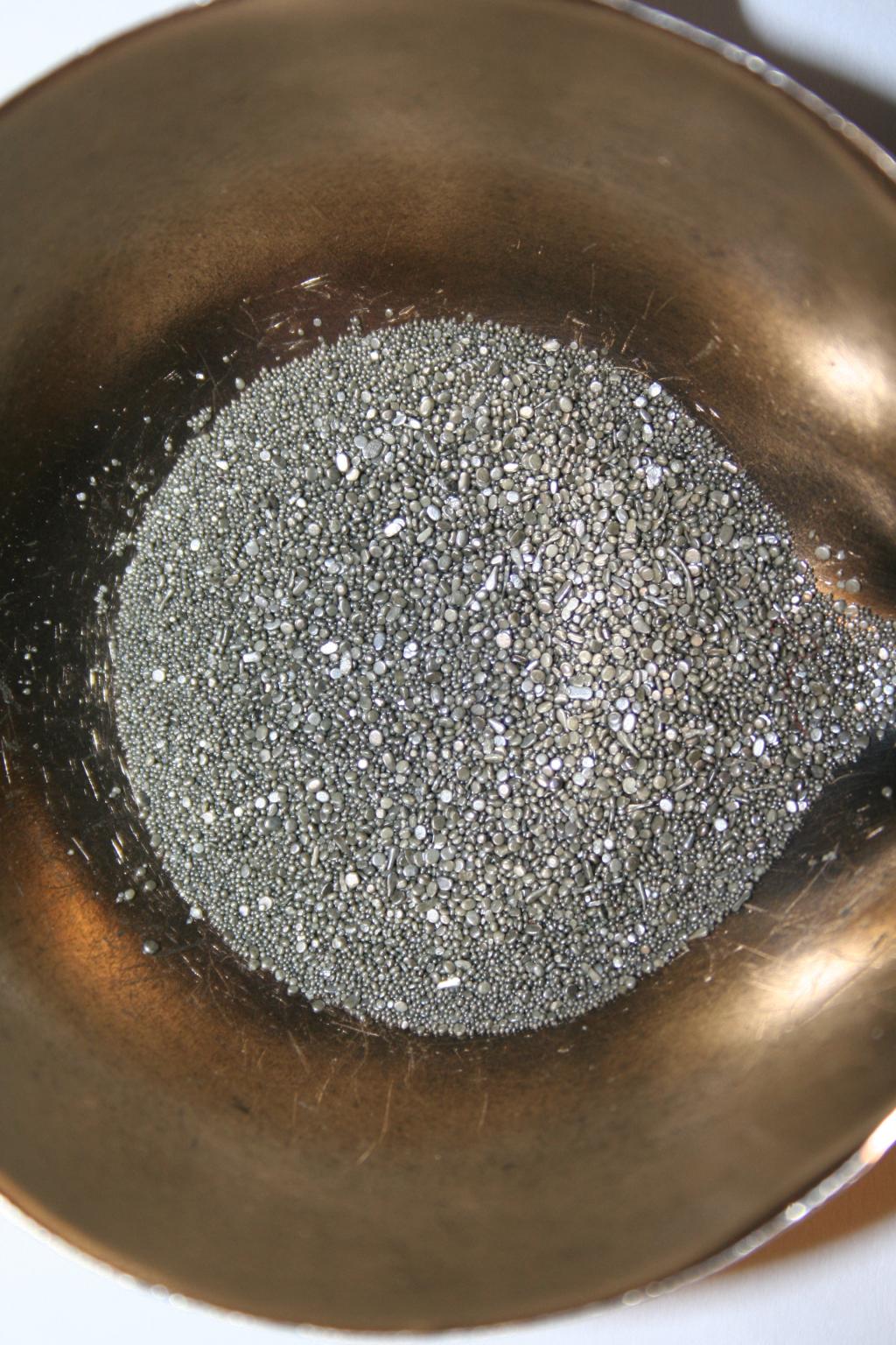

Powder Description/Positive ID/Type/Charge Weight: LOVEX D037-01 16.4 grains*
*(Very similar to AA#7 by weight)
 Or... Underwood 9, 10... whatever they are calling it  ;)
Sniper711
No it would be this one MAJOR PISTOL = D037-01

LOVEX is an Imported Power and Not sure but Powder Valley Inc. doesn't have the MAJOR PISTOL which equates to D037-01.
According to LOVEX it is *(Very similar to AA#7 by weight)
