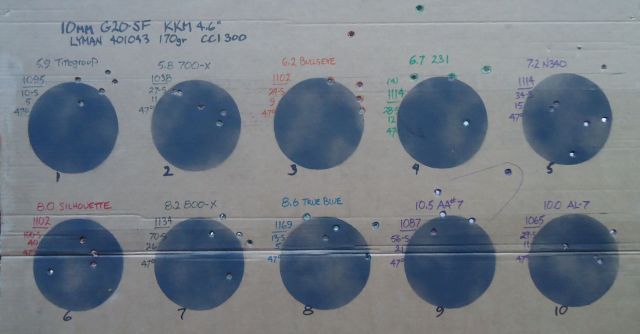

Benchrst
I'm curious about your results.
I've worked up about 260 loads for the 10, with most of them tested in the 35 - 50deg range. It won't get much colder here, so my obsession is on hold until it warms up, then I'll retest the ladders (up to 90deg).
By this time next year all the results should be graphed, charted, and plotted, and I'll have to find a new hobby  ;D

You can look (http://webcity.net/benchrest/10MMPublished/10mmAllPowders.html), but I really have no identical-loads-at-different-temps to compare (that process will start next spring / summer).
Have you considered an infrared light kit? I just got one, and the batteries should arrive next week - hopefully I'll get a chance to test it soon.
