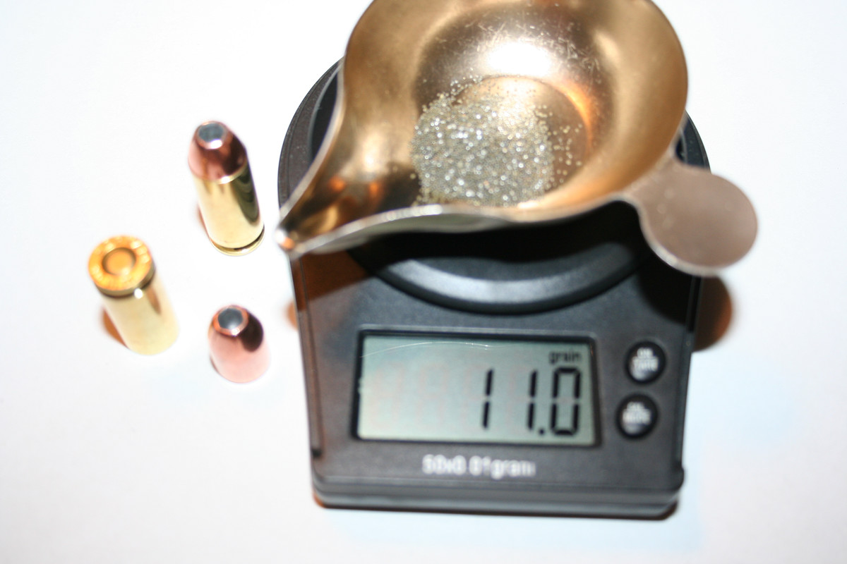

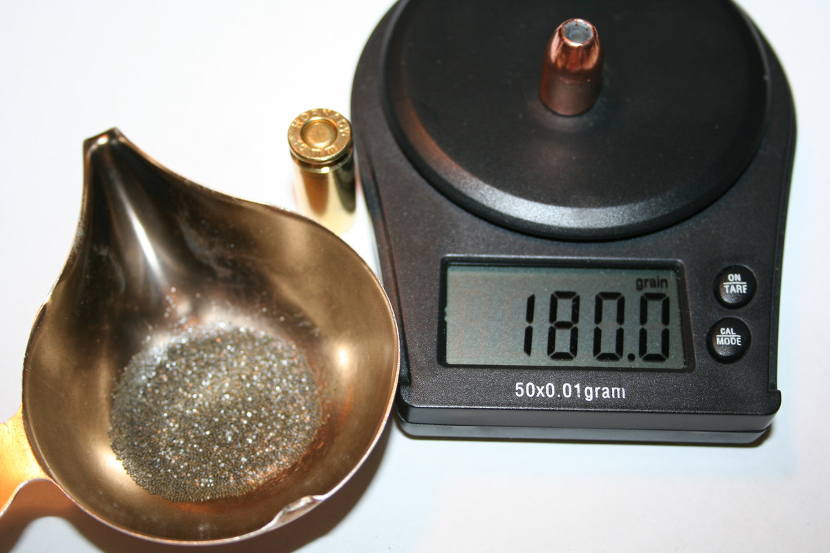

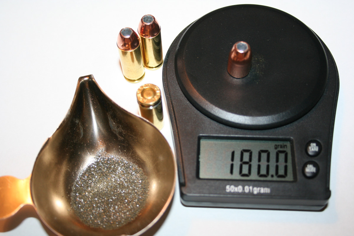

Actual weigh 181.0 / 179.6 / 181.6 grains  Concave Base / Crimp Diameter 0.3945"

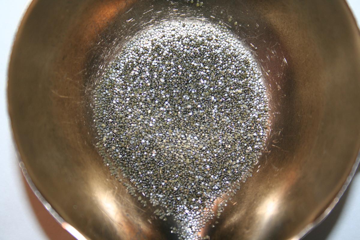

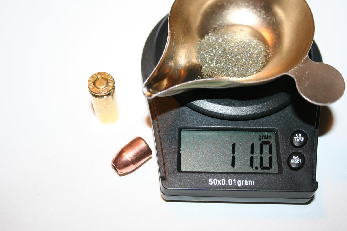

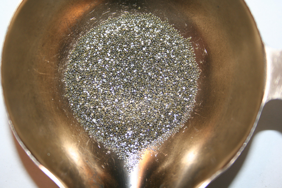

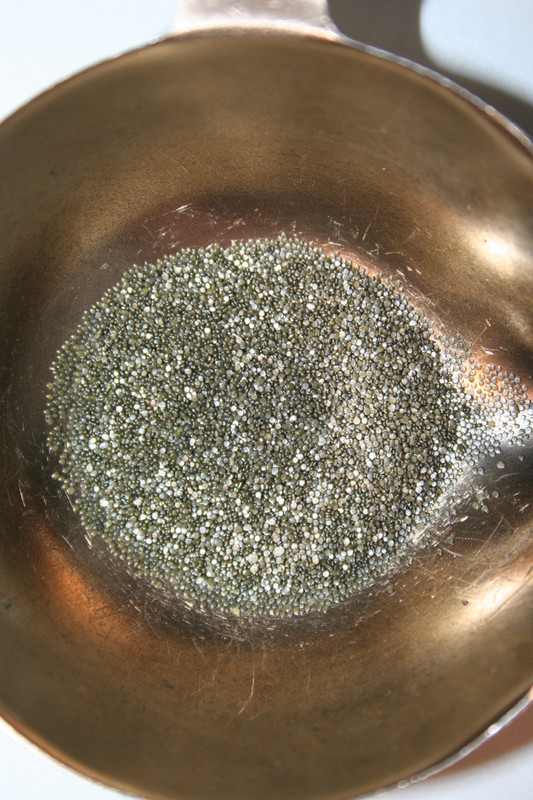

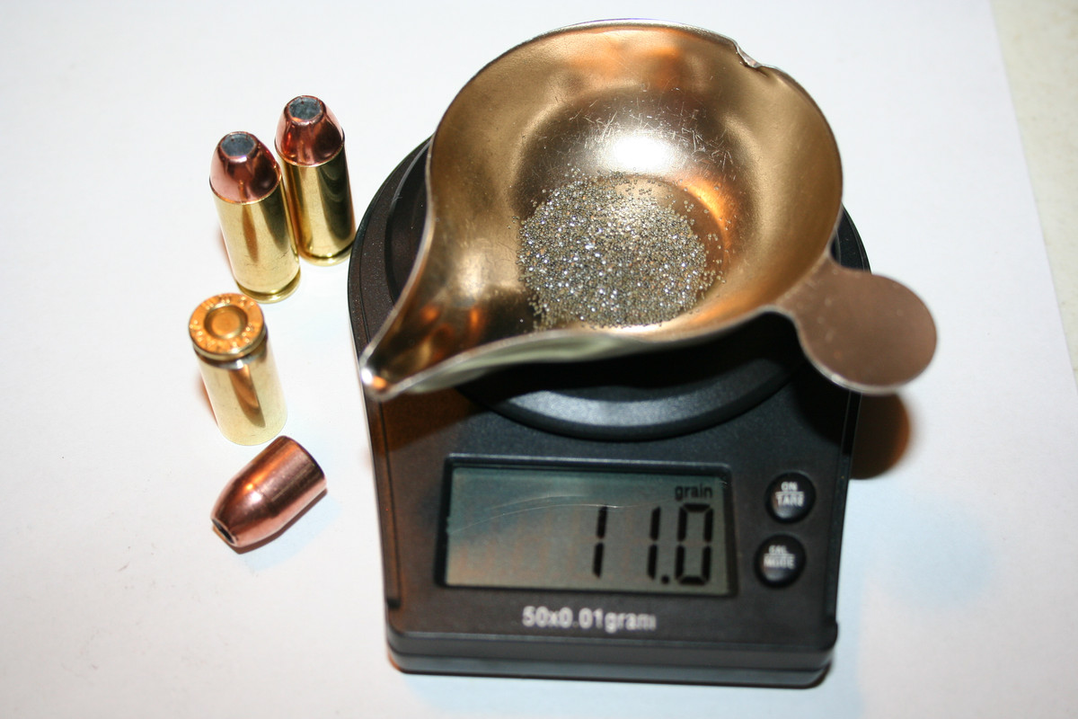

Powder Description/Positive ID/Type/Charge Weight: LongShot 8.6 / 8.8 / 8.8 grains
Cartridge weight: 284.8 / 285.4 / 285.6
